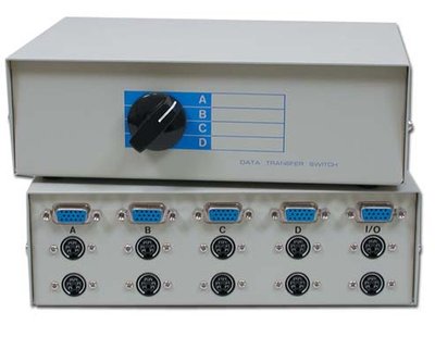

Reply 18 of 26, by dionb

Reply 19 of 26, by gdjacobs
dionb wrote:
gdjacobs wrote:
That or a KVM switch. Both AT and PS/2 will work (with adapters for PS/2).
How does a KVM-switch help with MIDI?
KVM switches are also very useful with multi-PC setups, but they just do keyboard, video & mouse (although some have serial and/or audio too, but none that I'm aware of MIDI)
AT keyboard connectors are same as standard MIDI jacks. PS/2 connectors are the same as the miniature jacks on SCC-1 cards and such. Any KVM that switches all five conductors straight through can also switch MIDI just fine. A KVM switch that buffers throughput will be an issue, so a purely mechanical device is ideal.
This old school type was what I was contemplating:
74.88 KiB
