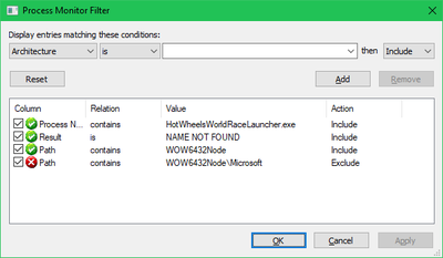

This game came along with a lot of old PC games I bought recently but I can't get it to install on any of my computers.
The setup program runs some sort of hardware detection routine that flags the cpu as incompatible and I can't get it to ignore it or skip it.
It says something like:

Reply 1 of 3, by ZellSF
Unpack it using Universal Extractor.
If you want to know how to solve this problem yourself later, then run Process Monitor with filters set up like this:

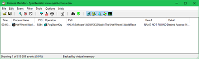

If a game needs registry entries and you're on a 64-bit system, they're likely in WOW6432Node. Run HotWheelsWorldRaceLauncher.exe and Process Monitor should give you this:
14.16 KiB
1760 views
Create that registry entry, then repeat the process until you've created all registry entries the game needs. Which in this case is:
HKLM\SOFTWARE\WOW6432Node\THQ\HotWheels\WorldRace\HotWheelsInstallPath
HKLM\SOFTWARE\WOW6432Node\THQ\HotWheels\WorldRace\HotWheelsCDPath
