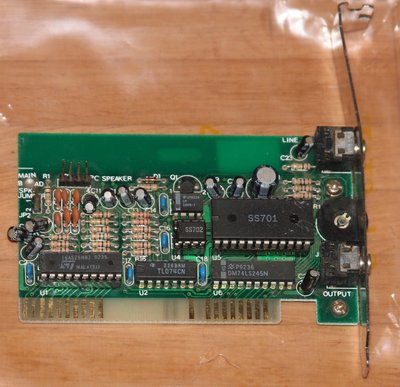

Just was looking through my box to find something I havent tested yet:

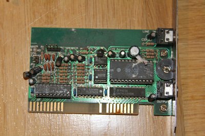

Also found a photo how it looked like as I got it...:

This little inconspicuous thing has some features I have not seen yet which makes it very useful for me:
- Adlib compatible
- PC-Speaker input and Output
- Line In- and Out
- Volume control
I have never seen 2 PC-speaker connectors on another card before. Just played with it: You can connect the Internal-Speaker-Output to the "Mainboard" connector and connect the Internal PC-Speaker to the "PC Speaker" connector.
In this configuration it forwards PC-Speaker and Adlib-Output to the Internal Speaker als well as to the external boxes! Therefore you can hear Adlib music with your internal speaker without having your amplifier connected.
Anybody else owns a card which can do this? 😎

I had a very similar card in the past, but I never tested this internal speaker functionality... I like the idea behind it though!

The SS701 and SS702 are probably an illegal clone OPL2 chip and its DAC. Nice and somewhat surprising they're socketed, given how cheesy the rest of the board looks.

Any chance you can provide a recording off of it? If they're clone chips like SW-SSG says they are then I'm quite curious to hear how they hold up under the scrutiny of something like Dune.
To make things easier you can find a program to play OPL2 VGM files here: SBVGM (DOS) VGM Player
And you can find the Dune tunes here: https://vgmrips.net/packs/pack/dune-ibm-pc-at

YES, I can 😉
To my surprise the VGM player didnt detect the card as Adlib. Therefore I installed Dune. Didnt know that game - thanks for the hint, really like the music!
My favorite is Populous. There I can hear no difference to a SB.
Populous Adlib.mp3

Many thanks! I just took a listen to the MP3s - I'm really surprised how close this is even if it has some subtle differences. It sounds like there's some sort of filter being applied to the signal that dulls the high end a little bit. Some instruments also sound a little crunchier, compare the snare drum in Dune 2.mp3 against how it sounds on a real OPL chip: https://youtu.be/Wdhx71OZNco

This no-name Adlib clone has a very nice PC Speaker passthrough. It's superior to the PC Speaker inputs on the Sound Blasters, which apply some filters that do ugly things to the sound.
