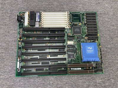

Reply 28 of 47, by Brickpad
I know you have a motherboard on hand, but if you (or others) are looking for a product made in the USA, check out the Mecer B860, and Diamond Speedstar VGA.
    324.55 KiB
    215 views

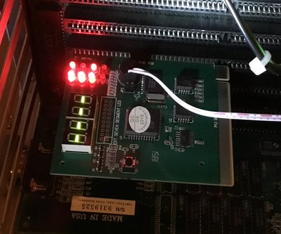

Reply 29 of 47, by Intel486dx33
I hooked up a PC analyzer with no results or readings. Not even computer beeps.
Any Idea ?
    543.58 KiB
    206 views

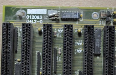

Reply 30 of 47, by Intel486dx33
Well, I could not get the last 486 motherboard to post so I have a NEW candidate.
In fact it is almost Identical to the Mecer B860.
Atrend VLB 486 Galaxy motherboard.
It has 128kb cache which I will see if I can bump that up to 256kb.
And it supports a 486dx2-50 or 66mhz.
I have some questions about this motherboard.
A) What does PGA CPU mean ?
B) What does PQFP CPU mean ?

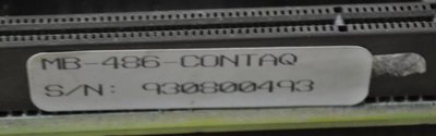

Update:
Okay , the motherboard is actually a “MB-486-CONTAQ 012093 U4L2-0 Socket 3 82C596, intel 486DX-33, 8Mb Edo Ram U.S.A”
Similar to this one By VisionEx corp.
https://stason.org/TULARC/pc/motherboards/V/V … OTHERBOARD.html
Does anyone know where I can get this CONTAQ manual ?
It looks like this motherboard was sold by many USA companies.
