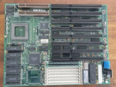

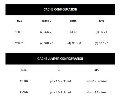

Reply 44 of 47, by Intel486dx33
Okay, What would I need to do to upgrade the cache to 256kb or 512kb ?
What size cache moduals and tag would I need and how many ?
The motherboard manual list that only 128kb and 256kb are supported.
It is a 1992 bios American mega-trends Phoenix.
4GPV3 486 VESA Motherboard
- BIOS ID string X0-0100-001117-00101111-060692-CTQ596-F
- 8-30 pin SIMM slots (1-128meg FPM DRAM)
- 2-32bit VESA Local Bus slots
- 8-16bit ISA slots
- 64-256k cache support in 8-28pin sockets + 1 TAG RAM sockets
- AMI/Award/MR Bios
- CONTAQ (German) 82C596 A Chipset
- Supports the following cpu's at 25/33/40/50/66MHz
INTEL 80486SX/80486DX/80486DX2, P24C, P24T
CYRIX CX486M6, CX486M7
AMD AM486DX/DX2
- Green PC Connector
- Manufactured by: Atrend Technology Co. Ltd. or VisionEx + CTL corp. 1993

Reply 45 of 47, by canthearu
I very strongly recommend you do not touch the cache.
The performance difference between 256kb cache and 512kb of cache on a 486 is very small. Don't risk breaking your system by trying this upgrade.

Reply 47 of 47, by Anonymous Coward
It doesn't support 512kb cache. The cache sockets are 28-pin, and to get to 512kb you need higher density modules that have 32-pins.
