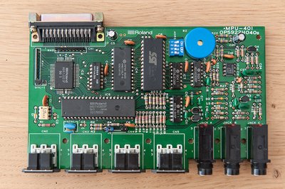

Reply 18 of 18, by suntac
I did some experimenting with my MPU-401 and it was quite fun. 😀
249.8 KiB
1036 views
MPU-401 with custom firmware
