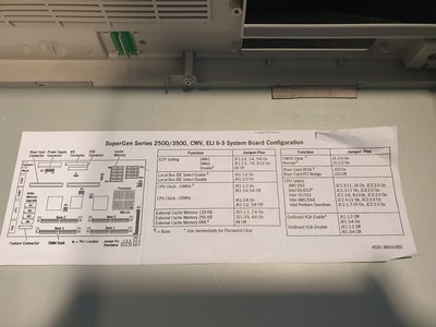

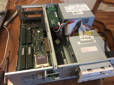

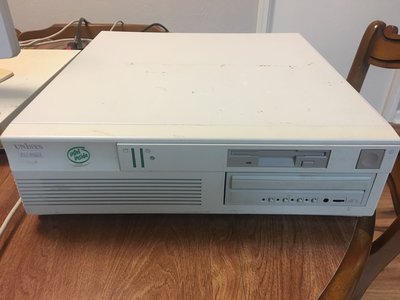

Hi guys, I picked this up about 6 months ago for 10 bucks and it works perfectly. I haven't seen much online about these at all, but it looks like a business PC from 1995. I was thinking about swapping the CPU and video card for something better, but not sure what it will support. I am more familiar with late 90's systems, as that is when I started building my own. But our first PC was a 486-66.
I really like how clean the look of the system is. It runs quiet and smooth, and I love the sound of it booting up, hard drive clicks and all.
Specs are:
- Unisys ELI-4663
- 486 DX2-66 (unknown Motherboard)
- 64 MB 72pin RAM 😲
- I have removed the 4-disk NEC CD-ROM changer for now, swapped for a single unit, but might put it back in.
- I swapped the network card for a Soundblaster 16, which works great.
- Currently running DOS 6.22 and Win 3.1.

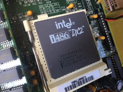

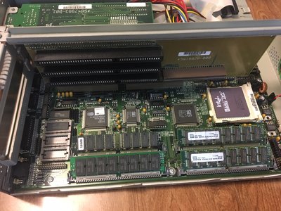

1) How interchangeable is a DX4-100 or faster CPU with this? Does anyone recognize this board?
2) What would be an appropriate upgrade for the on-board video? I can't tell how much VRAM is on-board for the Cirrus Logic chip. I don't have any VLB cards, only PCI/AGP.
3) Someone elsewhere pointed out the lack of L2cache, but I really don't know how to determine what type I would need, and where to find it.
EDIT: I just looked at my own pictures more closely and noticed the jumper info that says DX4 on it. 😊 So it should be able to take one, no?

Reply 1 of 11, by Baoran
For dx4 you need to be able to change voltage. That is most important thing that you don't break your dx4 cpu.
I don't recognize the motherboard, so I don't know if it has jumpers for changing the voltage. Maybe there are markings about changing voltage somewhere on it?
Reply 2 of 11, by tizzdizz
You're right, and I think there ARE markings (see my photos). I need to open it back up when I get home and see, but it looks like it's possible.
Reply 3 of 11, by The Serpent Rider
There's two voltage regulators on the board, which means it's 3.3v capable. In fact, the board has jumper memo near the socket which mentions DX4.

Reply 5 of 11, by claesbas
I got the EXACT same comp. In mine there is a diagram attached to the "roof":
471.2 KiB
1134 views
Hope that can help!

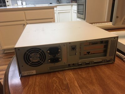

Reply 6 of 11, by claesbas
I have a question Three. In the middle of your system there is a extra IsA port with a small thin card (with some port on the back). What is this? I dont have anything here and there is a screwed on lid.
Reply 7 of 11, by Brickpad
There is a seller on Ebay who has a bunch of Trinity Works / PNY PowerStacker (AMD 5x86) CPUs for sale that should work with your system if you want to push it farther than a vanilla DX4.

Reply 8 of 11, by melbar
claesbas wrote:
What is this?
It looks like a modem card. The port can be seen at the backside of this case.
Maybe it is a 14.4k or 28.8k modem.
Reply 10 of 11, by claesbas
melbar wrote:
claesbas wrote:
What is this?
Ah thanks - so its a modem - I ask about this here you see: Extra ISA on "back" and some holes/lids on old case?
Just the thing on the left of that now (also like a lid with two screws) that is a question mark...
Reply 11 of 11, by treeman
don't forget a heatsink/fan if you go a dx4 unless you took it off for the pictures. I understand some systems with a dx2 cpu may have come without a heatsink
