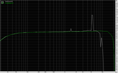

Reply 5 of 6, by tpowell.ca
As you can see from the attached picture, the frequency spectrum inexplicably narrows when using DirectSound under certain circumstances.
12.08 KiB
429 views
I have also attached a recording that clearly shows the problem.
One thing I did notice however; this only happens if not using the primary sound buffer.
Sorry for the choice of music, but I needed something with good dynamics. 😵

Reply 6 of 6, by Tiido
Ok, seems it is 8bit 22KHz in Dsound for whatever reason. That's definitely some sort of driver related problem. Actually I now remember that in Winamp I had to use secondary buffer or some related option when using Dsound for proper output. I never had issues in games though.
