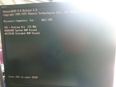

Can someone confirm me that W6-Li supports PII-OD?
I try to run SL3EA and they’re detected as Overdrive 266 and bios is freezing after mem counting with info that say power management is not supported on this tyle cpu. Bios is w6-Li-04 latest i think.
