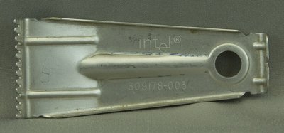

Reply 8 of 31, by gloomkeep
dionb wrote:
- chip remover for LIF-sockets (i.e old CPUs)
I can't recommend these enough. I went from spending two hours removing a stubborn 486 cpu with a screwdriver, to about 4 to 20 seconds with this tool (no matter how hard the CPU is jammed in there)

Reply 9 of 31, by red_avatar
gloomkeep wrote:
I'll need one soon since I got to remove my old 486 SX CPU that's in a LIF socket - can't for the life of me find that tool anywhere though.
Maybe I can find or make something myself that grips underneath the CPU on both sides so I can wiggle but damn, even removing an ISA card can mean a LOT of pulling and that's just a slot. This is pulling 168 pins from a socket.
Retro game fanatic.
IBM PS1 386SX25 - 4MB

Reply 18 of 31, by tayyare
red_avatar wrote:
gloomkeep wrote:
To say the truth, I was not aware of the fact that such a special tool existed.
Even back in the days, when I was working as a part time IT tech, we were using slot cover brackets to lever them out. Not the flimsy tin foil kind that is common today, I'm talking about the slot covers of the old times, which are thick and almost unbendable.
The process, as very nicely described by a fellow vogoner:
"The trick is to lever them out evenly. If you lift up one side too much further than the others, you will bend the pins. So lift up each side by 1mm or less at a time, and work your way all around the chip over and over until it comes out. It can be a bit of a lengthy process,"
But it worked and still works based on my experience.

Reply 19 of 31, by Errius
How do you extract chips where one side is so close to another component (e.g. power connector) that there's no way of slipping a tool down on that side?
