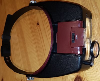

Reply 24 of 31, by Baoran
I think this thing has been very useful for me when finding corroded or bent pins, corroded sockets and corroded traces on motherboard. I have also used it when desoldering/soldering small stuff.
1006.93 KiB
262 views
