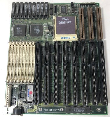

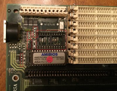

Dallas battery replacement ?
First post, by Intel486dx33
Should I use an external battery or replace the Dallas battery ?
If so, What Dallas battery model do I need ?
The Socket has 24-holes for 24-leg Dallas battery.
12-legs on each side.
Which side is "+" and which side is "-"
    762.48 KiB
    8691 views
    188.39 KiB
    8691 views
    89.5 KiB
    8691 views
    1.5 MiB
    8691 views

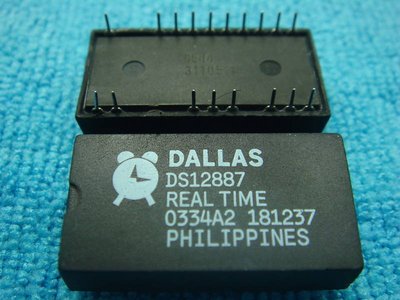

Reply 1 of 26, by dkarguth
Most of these computers use either the discontinued Dallas DS1287, or the newer Dallas DS12887/DS12887a. They are listed as "interchangeable" by the manufacturer, but they sometimes don't work correctly on some motherboards. On the socket, there is a notch out of one side that corresponds to the correct orientation of the chip. You will notice this is universal for all DIP sockets, there is a notch out of the chip that matches up with the socket. Also, that Dallas chip is not just a battery, it also has your Real Time Clock chip and some memory for storing BIOS settings.
You have several options with replacement. You can go on ebay and buy a DS12887 for around 5-10 dollars on average, and it might work. I say "might", because if it is an old chip, the battery might already be flat. Another option is to check out this link:
https://www.ebay.com/itm/GW-12887-1-DS12887-R … ab95j:rk:2:pf:0
It's a replacement for the DS12887 that rather than using an internal battery, it uses a button cell on top of the chip to power it.
I'm not sure what is going on as far as the external battery option. My best guess is that you might be able to install a dallas ds12885 with an external battery? the ds12885 is identical to the ds12887 except for the internal battery. In fact, the DS12887 actually contains a full DS12885 with some of the pins bent up!
"And remember, this fix is only temporary, unless it works." -Red Green

Reply 6 of 26, by dionb
dkarguth wrote:
The only problem is that the dallas chip contains the actual RTC and the SRAM that stores the BIOS settings. If he doesn't install a dallas chip and installs a battery instead, it has the battery but is still missing the RTC and CMOS chip. Or am I missing something here?
That depends on the type of Dallas chip.
The DS1287/12887 Realtime are just RTC and battery, the DS1387 Realtime RAMified is RTC, battery and 4k SRAM. The two are not interchangeable -if you put a DS128(8)7 onto a board expecting a DS1387 it won't boot. That's relevant, as there are drop-in replacements available for the DS128(8)7, either newly produced RTC modules by Maxim, or homebrew combinations of a simple RTC with a coin-cell battery holder. I'm not aware of any such replacements for the DS1387, there you have one option only: grab that dremel and mod the existing module to take a new battery. Which is what I'm going to do this evening 😉
TS, if you don't have the RTC that was on the board, you need to find out which was on it originally.

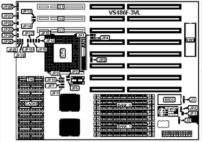

I looked up the motherboard, and the original diagram shows a symphony SL1287 in that socket, which is essentially a rebranded Dallas DS1287.
You seem to have the same motherboard being discussed in this thread: Symphony 80486 VLB motherboard
The motherboard info page is this one: https://stason.org/TULARC/pc/motherboards/U/U … VS486F-3VL.html
Unfourtunately, I could not find the original user manual, so it was most likely one of thousands of generic motherboards produced over the years. I would start with trying a Dallas DS12887 to see if it works, most of the time it's a drop in replacement for the DS12887. There are some occurrences where it does not work, however, so your best option might be to go the 1287 + dremel route.

Reply 9 of 26, by dkarguth
The battery in the Dallas chip is a 3v button cell. A CR2032 should do just fine. As for the orientation, normally you can tell 1 of 2 ways which way the chip is supposed to go. The one I have has a little semicircle shaped notch about 1/16 of an inch wide on the bottom of the chip near one of the ends. Other chips have a dot in one of the corners on the top of the chip. That dot/notch goes on the same side as the notch in the IC socket. You can see that notch in the picture you posted of the socket, it is the opposite side from the RAM slots.

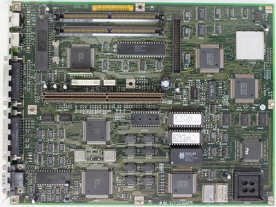

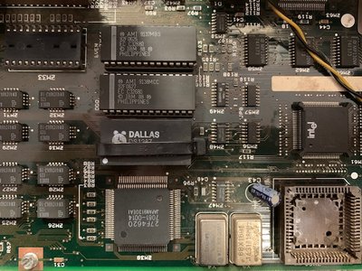

Is the Dallas chip socketed on the IBM PS/2 55SX mainboard (57F1536)? I can't really tell and I don't have the machine yet. It looks socketed but I need confirmation, one even has a cable tie.
