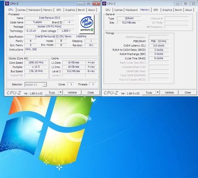

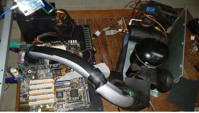

Reply 29 of 31, by Obijuan1983
Pentium III-S 1.4GHz @ 1.85GHz (Chilled @-8.5 C)
221.24 KiB
1161 views
271.51 KiB
1160 views

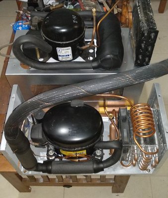

Reply 31 of 31, by Obijuan1983
I had a Chiller and I built recently a Singe Stage!
297.79 KiB
1116 views
492.29 KiB
1116 views
I will try the SS at the Pentium III-S 1400 soon!
