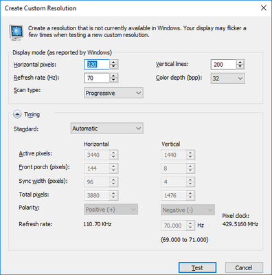

i tested just with the nvidia control panel, there is possible to set custom resolution. i dont know, they are "real" output resolutions or not - but many critical resolution worked. i created a table for testing the 2x-4x resolutions with a specific frequency.
https://docs.google.com/spreadsheets/d/1h8nLn … dit?usp=sharing
