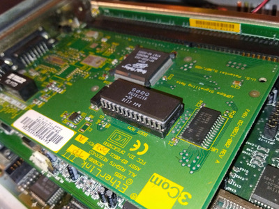

This thread was incredibly helpful to me in getting this working, so here's a more detailed set of instructions on my process end-to-end.
1. Bought an XTIDE card that can also flash EEPROMs, in my case Blue Lava Systems XT-IDE rev 4.1. Note that this uses address 300h by default. https://www.bluelavasystems.com/xt-ide/
2. Bought a few new EEPROMs from Amazon, 28C256 chips since they could deliver quickly. 256kb, 32kx8. VERY IMPORTANT to note that EEPROMs have a specific orientation when installing, or you fry your EEPROM. Look for the small half-circle and line them up. I was today years old when I learned that and this is why I suggest buying a handful of extra EEPROMs. https://www.amazon.com/gp/product/B07PF9QH5K
2a. If you are using the new 256kb EEPROMs, make sure you change the switches on the Blue Lava card, it's configured to use an 8K EEPROM by default.
3. Grabbed XTIDE files from the correct site: https://code.google.com/archive/p/xtideuniver … lbios/downloads (I used beta 3)
4. Booted from floppy, ran xtidecfg, loaded the original bios from file, in my case ide_atl.bin. Configured it accordingly, saved it back to the original file. It's important to edit/update/save settings in this step before you build a larger/padded/combined file later.
5. Copied the new/saved ide_atl.bin to a Linux box. This file was 12288 bytes to begin with. The 16kb target space would be 16384 bytes, so we need to pad by 4096.
cp ide_atl.bin ide_at16.bin (make a backup)
dd if=/dev/zero bs=1 count=4096 >> ide_at16.bin (file should now be 16384 bytes)
cat ide_at16.bin ide_at16.bin > ide_at32.bin (the ide_at32.bin should be 32768 bytes)
6. Copy ide_at32.bin to a floppy with xtidecfg.com. Also make sure that floppy has 3c5x9cfg on it.
7. Boot from floppy and run xtidecfg.
Load bios from file (ide_at32.bin)
Flash EEPROM
Type 28256 (32kib)
SDP command None
Page size 4 bytes
Start flashing
8. Reboot with the XT-IDE card to make sure it works.
9. Reboot to floppy, run 3c5x9cfg and configure the NIC. Modify to a base address of your choice (making sure to avoid 300h if you plan to test the NIC+XTIDE card at the same time).
Boot prom 32KBytes, address C8000h.
10. Use a chip puller to remove the EEPROM and install it on the network card. Be very sure you line up the half-circles or you fry the chip.
11. Remove the XT-IDE card and boot with just the network card, the BIOS should load for you.
Hope that is helpful for someone else.

mdog69 wrote on 2019-02-19, 13:03:
Short version: […]
Short version:
I got my XT-IDE BIOS working in a 27256 filled with 2x16k images, installed in a 3C509B.
Long version:
OK, here's what I've learned so far.
I have a 3C509B-Combo - the important thing here is that I have a 3C509B not an older 3C509.
I have an old Atmel 27C256R (120ns) EPROM - 32Kx8
The aim of the game was to use XT-IDE to allow me to access a 4.3Gb "mechanical" disc drive.
I also got my hands on the "Etherlink III Parallel Tasking ISA, (blah blah) Adapter Drivers Technical Reference"
available at https://www.janwagemakers.be/PIC18F452_3COM_3 … rnet/3c5x9b.pdf
From the Technical Reference document (and informed by 2764, 27128, 27256 datasheets) I found out the following:
3C509B
Supports all 28 pin ROMs - 2764, 27128, 27256, 27512 (No need for modified EPROMs or NICs)
Can be configured to use "8k, 16k, 32k and 64k" ROMs
If you select a 32k or 64k device, the device has a 16k UMA window, and the NIC uses a "ROM Option" register to allow bank switching in that window.
This means that the A14 and A15 pins on the ROM socket are driven, and are not floating.
3C509
Does not explicitly support 27512
Supports all other 28 pin ROMs - 2764, 27128, 27256
Can be configured to use "8k, 16k, 32k" ROMs
If you select a 32k device, you get a 32k UMA window, which means A14 is determined by the ISA bus, and the whole device is exposed.
It is possible that for 8k and 16k modes the A14 pin (pin 27) is tied to Vcc (this pin is "not program enable" which is usually set to Vcc for read operations)
It is highly likely that the A15 pin (pin 1) is tied to Vcc (this pin is Vpp which is usually set to Vcc for read operations)
From practical experience
If you use an old configuration program, you can only select 8, 16 or 32k devices.
If you use an old configuration program on a 509B, chosing 32k device will result in a 16k window as per the hardware design.
If you do not have a ROM installed in the NIC, the configuration program will give the warning message that others have seen.
(Hint: The program probably looks for the 55 AA signature at the ROM base address, and nothing else)
I did the following:
Target PC configuration
* Installed the 3C509B with no OM onboard
* Booted the system with an old MS-DOS hard drive (540Mb) and ran 3C5X9CFG to select 16k ROM at C8000H
Got the warning message, went ahead anyway.
XTIDE image preparation
* Copied IDE_386L.BIN and XTIDECFG.COM to an MSDOS virtual machine. This created a new IDE_386L.BIN which was 10k in size.
* Copied the new IDE_386L.BIN file to my Linux box, padded it out to 16k (dd if=/dev/zero bs=1 count=6144 >> IDE_386L.BIN )
* I then created a 32k image file (cat IDE_386L.BIN IDE_386L.BIN > IDE_386L_27256.BIN
* I then loaded this into my EPROM programmer and burnt the EPROM.
Testing the EPROM
* Powered off the 486
* Inserted the EPROM in the card
* Got the expected output from the new BIOS extension and Successfully booted off the 540Mb
* If I have any problems from this point, it's down to XT-IDE.
So, to end:
The 3C509B drives the EPROM A14 and A15 lines, no need to modify EPROM or card.

Wanted to shove my two cents in this thread because it was immeasurably helpful to me, and hopefully my experiences are of help to someone else down the line as the ones previous to this message were for me.
I bought some new old stock SEEQ DQ28C256-30 EEPROMs off eBay a couple weeks ago and finally got a XGecu T48 in to program them, as not a single XTIDECFG utility will work with these chips at all, possibly because the chips I have are 300ns and the utility is assuming for something a bit faster.
As others have done like quoted above, set the 3C509B with 3c5x9cfg for your choice of boot address as you've configured in your ROM file. in my case, it's D8000h and I chose the 16k size option. As this is a 32k ROM, we need to pad the file to 16k and then duplicate the ROM to fill the remaining ROM space.
Where my experiences differ is, I used a program called padbin to pad out ide_atl.bin found at this blog post comment or directly. it seems that the creator rewrote a piece of code that came with a "gbfs" zip file meant to pad gameboy ROM files. in this case the syntax to use is
padbin.exe 16K ide_atl.bin
and you should end up with a 16K ROM file. Alongside the EXE file in the zip is a .cpp source file, and the original code is GPL'd.
From here I stuck it through HxD Hex Editor and just had it concatenate the file twice on itself (no need to open the ROM in the program, just go to Tools > File Tools > Concatenate... and it should give you a prompt to add the file to twice and a box to name the output file and where.)
Took this, opened it in XGpro (in my case, v12.57) and selected an Atmel AT28C256@DIP28 as the closest living relative of the destination chip, as Atmel bought all of SEEQ's ROM stuff in 1994 or 1997 IIRC when they restructured.
I erased the chip a few times to make sure for-sure it was blank, did a blank check, and wrote the file to the ROM. Don't forget to reverify afterwards of course. Note that this chip doesn't need protection disable/enable done as allowed by the program, you can safely uncheck both of those as this chip predates software data protection schemes.
Popped it in, and it worked. it just worked, the first time, and every subsequent boot after.

Attached is a picture of all of the ROM chips I have of that SEEQ variety. This was only meant to be a proof of concept to show that the T48 can properly program these enough to work, and I wasn't expecting any of this to work as 300ns is way slower than most other ROM chips ever used in an XT-IDE setting... The OG Rev1 Hargle cards used SEEQ 250ns plastic-encapsulated EEPROMs for a time, but these were found to be very unreliable as time went on and writes were performed to them. As the ones I have here are from pretty much year 1 of the 28C256 being a thing for SEEQ in a real capacity (not to mention being the ceramic-epoxy-ceramic Oreo variety), I'm expecting them to last a bit longer, but time will tell.
    802.77 KiB
    1019 views
    Installed in 3C509B, notch towards the ports.
