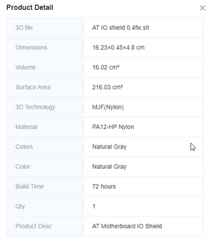

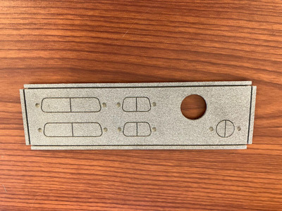

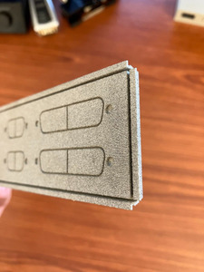

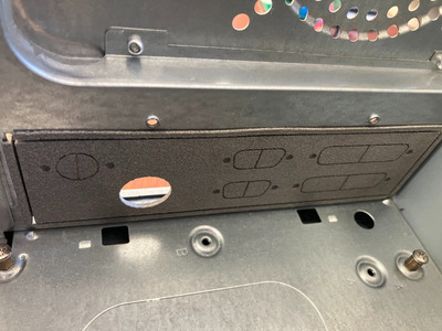

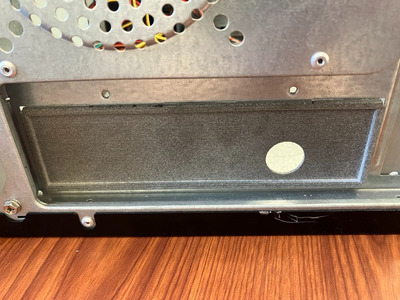

Gave this a try using jclpcb.com as my printing service. It was my first time sending a model in printing so I had no experience with this at all, so I had some difficulties choosing what material and printing style would be the best. I took a chance and placed an order using PA12-HP Nylon. So far I am very pleased with the results. The material was very cleanly printed, strong, and had pretty good flexibility. Fitting it into the case is quite snug, especially in my case the shield hole has a couple of very thin notches in one side of it that were sharp and pressed into it. You will see where these notches pressed in and scratches the edge of the printed IO plate. Overall I would say it handled this stress well. The IO plate fit very snug, but I was also able to remove it without too much force or breaking anything. I would say the material worked very well.
Cost of the print was around $9 + shipping costs. Overall I am very happy with how it turned out, and would do it again if needed for another system.
