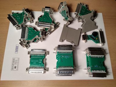

A little status update:
944.35 KiB
3090 views
I have reached the conclusion that it wouldn't make much sense to package DIY kits for the Covox Speech Thing and FTL Sound Adapter replicas.
There's so little in there that it would almost cost more time and money to safely package the individual components and ship them in a box than to assemble the unit and to put it in an envelope.
As you can see, the devices are already ~80% assembled and they are arranged on a test print for the labels.

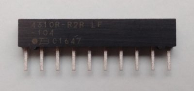

The heart is still missing, though: I don't have the R-2R resistor networks, yet, but they should arrive here within the next couple of days.

Some more components have arrived. This is one of the resistor networks:

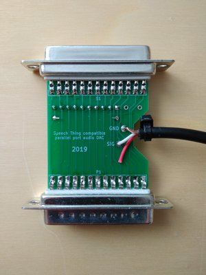

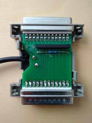

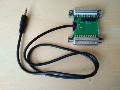

And when it comes to Covox Speech Thing replicas, I think this is about as close to the real thing as we can get:

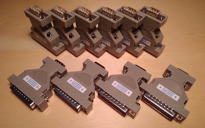

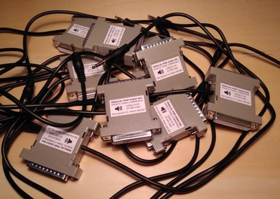

Reply 63 of 93, by Benedikt
Finally done!
536.19 KiB
3026 views
592.71 KiB
3026 views
Challenge for the reader: Try to get closer to the real thing!

Reply 66 of 93, by Benedikt
Jo22 wrote:
Just one thought - What about adding an optional capacitor ?
The original Speech Thing had one as a low-pass filter inside the external speaker, if memory serves.
If you scroll up you can see that there's a footprint for a filter capacitor on the PCB. Populating it with a 4.7nF capacitor makes the audio output electrically identical to the FTL Sound Adapter.

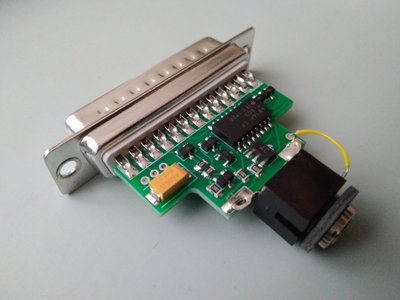

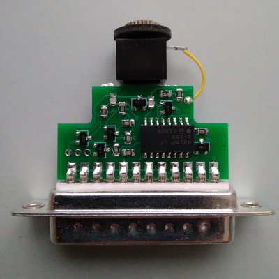

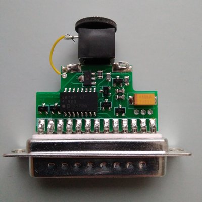

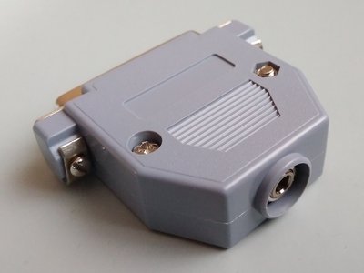

But I've got news, as well: After roughly one hour of soldering, here comes the first SoundJr replica:
This is the finished product:
179.88 KiB
2838 views
And this is what's hiding inside:
232.3 KiB
2838 views
There's been some component substitution that I described earlier in this thread.
349.76 KiB
2838 views

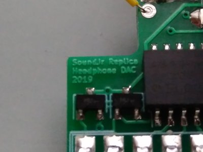

The two 1nF filter capacitors are pure guesswork.
329.47 KiB
2838 views
I put the word "replica" and the year on the PCB so that no one can mistake it for the real thing.
73.78 KiB
2838 views
So far, I've been able to get sound by using it as a generic LPT DAC, the volume adjustment, however, remains untested.

When I put a 390Ω resistor between pin 12 and 17 of the pass-through port of a Speech Thing replica, Dungeon Master will detect it as FTL Sound Adapter. Let's play it safe and use 220Ω for the replacement resistor packs in my FTL Sound Adapter replicas. (They currently use 2.2kΩ resistor packs.)
So that's the solution. There is a problem with the Speech Thing replicas, though.
I have been testing them with active speaker boxes that are not labeled as left or right and kept wondering why they do not produce any sound when I switch them from stereo to mono mode.
It looks like the cables I used for the Speech Thing replicas are of the kind where red means left and white means right. 😵
