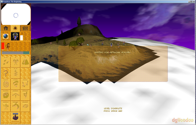

Hi!) Thanks a lot for dgVoodoo! Its awsome!) 😊
If i play through pop3 matchmaker(https://www.popre.net/downloads.php) i have this issue with water textures. Without matchmaker no issue.
Version dgVoodoo2_54 works good. But upper versions have issue with water textures. Problem is in DLLs - D3D8.dll, D3DImm.dll, DDraw.dll
here screenshot

Reply 1 of 2, by ZellSF
It's a known issue with AMD cards, but Dege doesn't have an AMD card or any ideal test case application to submit to AMD if he knew what was wrong.
There's no reason to use the latest version of dgVoodoo for Populous: The Beginning though.
