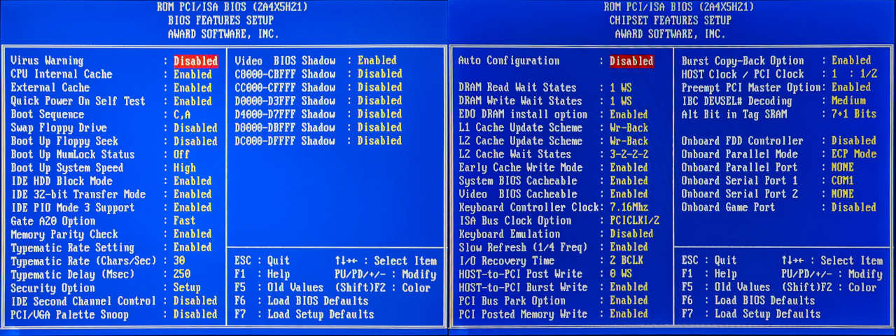

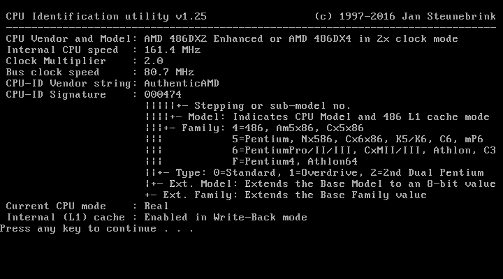

A while ago somebody pointed me to this video where the author shows AMD Am486 DX2-66V16BGC CPU running at 2x80MHz.
This naturally picked my interest and decided to see for myself what's there.
It looks like that DX2 model is Am5x86-P75 / Am486 DX5-133W16BGC in disguise. Same properties, but 2x multiplier instead of 4x, which opens the path for experimenting with 80 or 83 MHz base frequencies.
I have only two of these chips. Both worked just fine.
As a side note - one of them likes 3x60MHz very much, which is rare for BGC variants. I can get it to tick without active cooling, but didn't explore this in depth.
Since the video shows Shuttle Hot-433 revision 4, it made sense to try that first. Used the motherboard showcased here.
Clock generator set to 80MHz.
3.45V to CPU.
256Kb level 2 cache only. 512Kb is hard no go. Used several sets of trusted chips.
Even with reduced cache size L2 CACHE WAIT STATES must be set to 3-2-2-2 or POST never completes. Limitation seems to be in the motherboard.
Magical 16Mb 60ns EDO RAM that allows DRAM READ/WRITE STATES = 1 WS.
Tested with Matrox Millennium MGA 4Mb, ET6000 4Mb, Cirrus Logic GD-5480 4Mb, S3 Trio64V2 4Mb and few other graphics cards. They all work.
AWARD BIOS instead of the default AMI one for slightly improved performance.
Check CPU confirms 2x80MHz

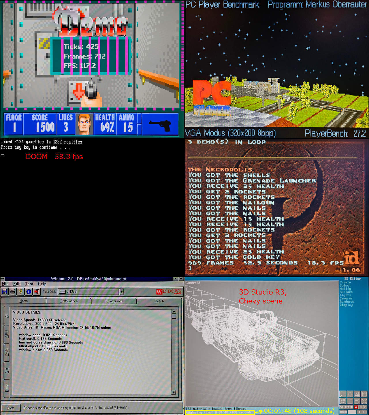

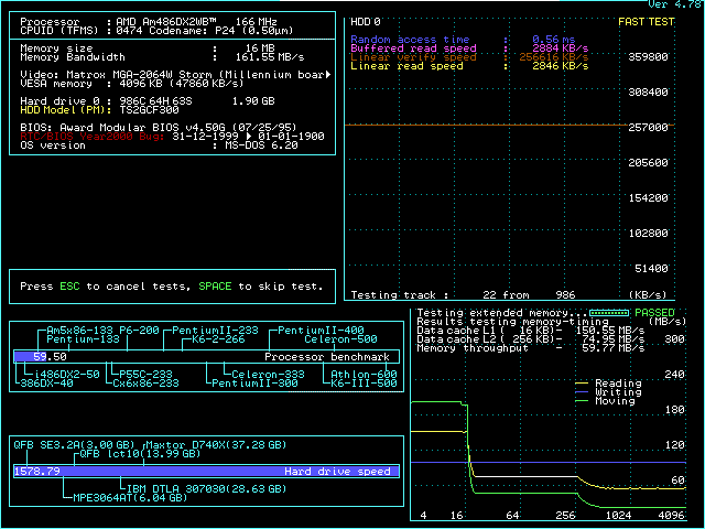

Here is what SpeedSys reports. Didn't use the UMC IDE driver at this point. It is a known quality - boosts file I/O to about 5-6 Mb/s.
And couple of screenshots with some of the tests.
MGA produces some artefacts in Wolf3D. They appear only on the side bars and over the framerate status at the end of the test. Otherwise the game viewport is clean and completely playable.
Quake 1 shows excellent framerate - one of the best out there, but all other results are mediocre at best.
The required high L2 cache timings and the PCI bus divider of 1/2 base frequency impose hard limits on the performance.
