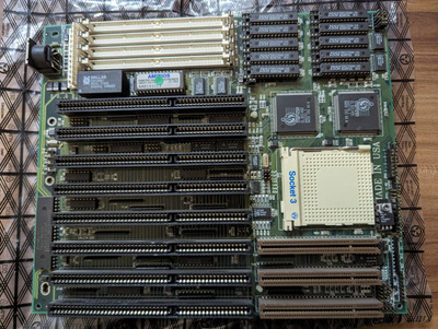

I think I got the same board now.
1.74 MiB
963 views
A bit dirty, but otherwise in a very good condition.
It allows for 1MB L2 cache, the Dallas chip is socketed, there is even a mouse header (but I am a bit confused that it is 10pin).
Not tested yet, but I will do it soon.
EDIT: I will make a shoot-out against the SV2GX4. I guess the SV2GX4 will win, I really like the 159 in Wolf3D and the 66.7 in Doom 😁. On the other hand this board seems to support 128MB, which is somehow nerdy and I like it. We will see.

Any indications it was in a Dell? First half of 486es Dell seemed to like bus mice and some of the boards from them had onboard busmouse header.
Reply 2023 of 2164, by CoffeeOne
BitWrangler wrote on 2024-02-27, 18:17:
I have no clue about the origin.
So 10 pin is a bus mouse header? I guess will stick to a serial mouse then ....
Reply 2024 of 2164, by BitWrangler
It's a possibility to bear in mind, can't say for sure.
Reply 2025 of 2164, by pshipkov
@CoffeeOne
Cool. My favorite Symphony Haydn 486 board.
Looking forward to see what you derive from yours.
Will be interesting if it matches my early findings.
These are too rare to be Dell related.
I cannot remember how big Dell was at the time - let's say 1995.
Inclined to think these boards are some industrial equipment, but who knows.

Sorry for nitpicking, but it is Wagner.
Reply 2027 of 2164, by rasz_pl
confusingly https://theretroweb.com/motherboards/s/young- … ga-486-green-pc doesnt acknowledge 10 pin header and claims its a ps2
Reply 2028 of 2164, by CoffeeOne
The Bios string of my Wagner board is 40-1800-006259-00111111-121593-SYM WAG-H. Retroweb lists one with the same number but 2800 instead of 1800. Is it relevant?
EDIT: So the board works in principle, of course the Dallas is empty. I ordered the Necroware thing and will continue testing when I got it.
MORE EDIT: This 1800 seems to be the version number. So I probably should upgrade to the 2800.
