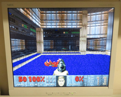

The default for DOOM is with the utility/weapon bar at the bottom. I feel this is the most natural configuration to benchmark DOOM. Quake also has the utility bar at the bottom. I don't know why Phil's bench pack is benching without that utility bar, but it is not how we were benchmarking DOOM before phil's compilation came about.
Unless stated otherwise, all my DOOM benchmark results posted on this forum have been with this view:
273.56 KiB
1011 views
it contains a maximised screen with the the utility/weapon/health bar.

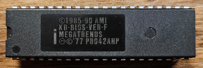

Keyboard controllers matter.
Realized that i never touched on an important detail that i bet many overlook during their 286/386/486 overclocking activities - the keyboard controllers.
For reaching and surpassing
- 25MHz at 0 wait states for 286
- 50MHz at tight timings for 386
- 180/200MHz for 486
it is important to have the right keyboard controller inserted in the motherboard.
The 486 case is less affected by them but they still matter.
The side effect of incapable chips will result in all sorts of seemingly unrelated issues. For example:
- flaky IDE controllers and local storage devices, including not being recognized entirely during POST
- if lucky to boot to DOS or other OS - random hangs, probably key press spamming, or invalid signals
- memory parity check screens out of the blue
and so on.
Often the difference between overclocking success and failure hinges on these chips.
The solution ?
Use AMI's KB-BIOS-VER-F.
They are the best and make a very real difference.

Probably most IC's have an impact on 286 and 386 systems which are being pushed way beyond their operating parameters.
Unfortunately for me, AMI's KB-BIOS-VER-F controller, if I recall right, lacks PS/2 functionality. All my systems are setup with PS/2 mice. Do you have a comprehensive list of all the keyboard controller modules you have tried; what notes accompany each controller? Maybe there are some with PS/2 which meet your requirements.

Reply 2055 of 2164, by feipoa
My memory is certainly not infallible, in fact, it has become rather error prone. Thus, I went to check, and I do have an AMI KB-BIOS-VER-F that is sitting in my bin of KBC-PS2 rejects. If you say it works with PS/2 mice, then it could be that some boards are acceptable with the KB-BIOS-VER-F, while others are not. I've run into this situation a few times. Or, it could also be that I removed the VER-F from a motherboard because my PS/2 adaptor already had a Holtek on it, and I didn't bother to test VER-F w/PS2. Nonetheless, as I am in the mist of assembling several PS/2 KBC adaptors, I will test VER-F again. If the VER-F works with PS/2 mice, and pshipkov says it is a possible solution to tight timings, all the better! I will use it on my SXL2-90 build, which is already at the limit of my motherboard.
EDIT: I can confirm that the KB-BIOS-VER-F also works in PS/2 mouse mode.
