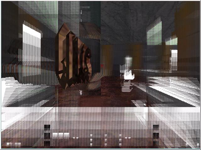

Reply 144 of 196, by Nicht Sehr Gut
DosFreak wrote:
"We have exorcised the demons!"
Don't jump the gun. Here's a pic from the 1st part of the 1st level, right after opening the doors in the crypt. You can see the gravestone and the post near it clearly. There's still a problem with erasing and re-drawing on mine. Using the latest OpenGlide DLL. Closer to what it should be, though.
    53.13 KiB
    1689 views

Reply 147 of 196, by Glidos
Unregistered wrote:
What blood looks like on my winxp (still not sure why it even works?)
That's exactly how it look for me when I have the resolutions mismatched. Exactly.
Ah, you must have BUILD_640X480 set to 1. It doesn't mean what it says. It means use the value sin the cfg file.
