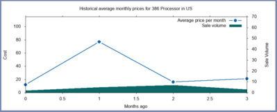

But, as more interest to this group, I've written a series of scripts (which use the ebaysdk) in Python that allow me to search and categorize vintage computer sold related items on eBay. This way we can have an idea as to what to expect to pay (or ask) for an item. I have them separated by computer systems (Kaypro 2, etc), consoles (Nintendo 64, etc), components (Sound Blaster 2, etc) and software/games (Kings Quest V, etc). The data they produce is integrated on my website here. If you click on an item you will actually see individual sold auctions.
>>>>> eBay Vintage Computing Historical Price Database <<<<<
Notes / Features:
- the average price is weighted based on age. So that more recent sales weigh more.
- it only searches SOLD items, not ended.
- the search is NOT perfect. I am adding more logic and filters to make it better
- the scripts run once ever day or so. The longer this runs the more data we'll get
- supports multiple regions with local prices (UK, US, DE, etc)
- games' prices are separated for sealed vs normal
- graphs for prices over time (and sale volume)for each item in each region

Reply 1 of 62, by meljor
I am interested in 3dfx. So I check your voodoo3 section of sold cards and I find that 3 of the ads are ''ended'' (not sold?). I also see a voodoo3 PCI in there which is normally a higher price compared to an agp version. I also find one voodoo2! and a voodoo4! PCI in that same list..... voodoo4 pci is much more rare and expensive.
Sorry but that's a LOT of mistakes in just one very short list. It's taking the average price of a voodoo3 to around 100 dollars which is way too high. Some people may ask that but I bet very little got sold for that (unless they are boxed etc.).
Voodoo2 section: The highest price of 180 dollar (jacking the price up a LOT) is for a sli SET, not a single card..... 2nd price is ''ended'' (not sold?). So again, a lot of mistakes in just a very tiny section.
Agreed. I am adding more filters now, basically what NOT to look for, what to exclude, so that the results are more accurate.
I'll add an "exclude" rule for "set".
However no matter how much I refine, there will always be items in a category which do not belong there. My hope is over time, they will be less impactful to the overall price as most items are correct.
Reply 3 of 62, by vladstamate
Ok, I've changed my scripts to now account for a list of exclude and include keywords associated with each item. Only the Voodoo's have such keywords for now, but I will work to add them to all items. As such what it finds is now correct (for 3DFx).
I've also separated Vood3 PCI and AGP in their own categories.
Reply 4 of 62, by sf78
Great idea, but like mentioned previously, there are severe errors in the listings. For example, the MT-32 gives one listing for a CABLE that is used with it, not the actual device. Same thing for the 387 math co-processor, one of the listings is a whole 386 mainboard which just happen to have a 387 attached. I really like the idea of this website, but it seems to need a lot of hard work to make it work. Also it would be great to have UK/DE eBay listings, because hardware and software prices vary a lot across the pond. Best of luck!
Reply 5 of 62, by vladstamate
Thank you for spotting those. I've turned the knobs in the logic for Sound canvases. The 387 category looks good though.
The other thing I fixed is I only log at actually SOLD items as opposed to ended. That was intention originally, but my scripts had a bug in using eBay's API.
