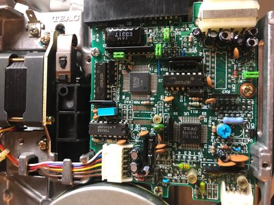

As promised, attached is the picture. I had to reduce the picture as the original size was 3MB and the forum posting only allows 2MB. I am curious if Deunan thinks this is a Shugart drive. I found a manual online of not my exact model, but I think it's similar. Not sure if jumper settings can get this to work or not.

Reply 13 of 22, by Deunan
Yeah, that's a Shugart FDD, there's a pinout in this datasheet that confirms it: http://v1050.classiccmp.org/chipset/fd55.pdf
And a bit weird one too. See that jumper below that shiny black box? It's set to RY, which means the pin 34 is /READY and not /DSKCHG like PCs expect. That would be the DC jumper position but the pin is missing so jumper or not, can't be easily changed. This is the why you get that short spin and then an error, a /DSKCHG should go away after a seek and /READY does not, obviously.
It would work if connected as B drive (so, before the twist in the cable) since then both drive select 1 and motor on match the PC signals. But even if you rejumper it to DC, it will probably confuse the hell out of the FDD controller since it can't do HD as you noticed - and the photo is a bit short but I think I found the ebay listing and you can see there is no LED or switch on the right side of the drive. There's only one near the spindle (first sector detection) and one for write protect on the left. And again the doc confirms it.
It might just be possible to use it as 360k PC drive. Doc says 320k but it is quad-capabe so I think it will work with 9 sectors per track just fine. But it can do 80 tracks unlike a typical 360k drive so there are various DOS tools for weird floppy formats and you could maybe use that to get 640k or 720k out of it. I'm not sure it's worth the trouble though.

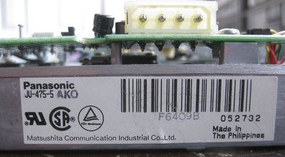

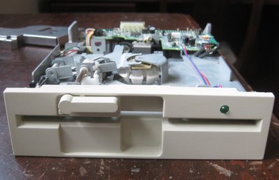

I have a Panasonic JU-475-5 AKO drive which is 5.25" as well. I have never been able to get it working. I no longer recall where it came from. I've attached some photos of it. Jumpered wrong? Should it be able to work in DOS/Windows, or does it suffer the same fate as the other poster's drive?
I have a post-it note on the drive which says:
Defective
-Disk I/O error
-General Read Failure
-Cannot read sector

Reply 18 of 22, by Deunan
Huh, weird that it has DS1-DS4 selection, not DS0-DS3. But in this case DS2 is correct setting for B drive, and probably won't work otherwise anyway - having 4 selections mean it's a Shugart too. It's set to DC so might just work, try it as a 360k drive as it seems not to have HD mode either but I can't tell for sure. If it doesn't work I'd have to look up the rest of the jumpers.
