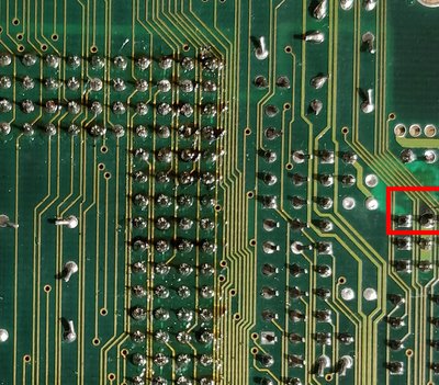

Reply 50 of 102, by Deksor
Jumpers 32, 34 and 35 control the voltage (so the white one and the two blacks underneath it)
All the pins in the socket seem to have 0ohm continuity.
After paying closer attention, I noticed this
363.63 KiB
464 views
this is the other side of the jumpers that control the voltage. See that black mark ? It's not a shadow, it's something on there.
Also I remember having difficulties removing the jumper on that was on this exact same pin, so it's highly possible the trace inside the board actually burned !
Edit : so I've put a jumper wire (of course I've checked that it wasn't shorted with ground, and it's not) and now the CPU receives 5V and heats up.

Reply 51 of 102, by Deunan
Ah, so it is burned out after all. I did notice the darker area but I thought it was also flux residue you mentioned.
These mobos start with no cache and no RAM, just CPU fetching code from BIOS ROM. So just the CPU, BIOS and test card should give you codes, first for the missing RAM and then maybe due to missing cache chips. If you get no codes at all it's not going to be an easy fix.

Reply 59 of 102, by retardware
The PCB layer delamination is clearly visible.
And the solder tin is opaque, while it shines on other places.
Guess this must have been some poof sound and magic smoke 😀
