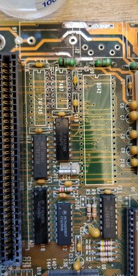

Moving on back to the Abit FU3 (386DX motherboard with two missing simms slot).
The other day I removed the two corroded chips near the battery slot, and I also removed the keyboard controller's socket to treat the corrosion.
1.89 MiB
282 views
The discoloration is just the flux that reacted with the corrosion (there's no discoloration on the KBC part for example). Sadly, I have damaged some vias (corroded solder joints are hard to remove ...), but they still make contact ...
As you may see, there's also a broken resistor over the 7407 spot, but hey it still works and it's none of my concerns for now 😁
So I checked for continuity and they all traces still work. So I cleaned all this mess some more and put new sockets and I reinserted the chips in there.
Then I tested the board and ... nothing has changed.
So I guess the corrosion didn't create that issue (although it was probably going to make things even worse !)
The POST code do this : 02->06->13, then it stops changing for a while, and then it falls to 00.
Also, I plugged a PC-Speaker in there, and it makes three long beeps with long pauses, then it stops and then it does this again, then stops ... forever.
I guess this is RAM issue. Just to make sure, I installed cache and made sure everything was properly configured, it didn't change, then I sprayed some contact cleaner in the RAM sockets, but it that doesn't work, I think I'm going to remove all the SIMM slots and put some other slots I will salvage from another motherboard.
I wonder if some of the traces of the SIMM slots aren't just common to all of them, and *maybe* the last slots are where the traces are supposed to go to the chipset. And looking how poor the desoldering job was made there, this is highly possible that some traces are broken. So perhaps replacing all the simm slots and making sure that all the traces are working will fix the board ?

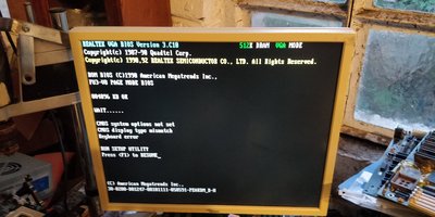

Anyways, as the iron was hot, I though why not test my theory for the Abit FU3 (386DX motherboard), so I inspected the area where there are two missing RAM slots and I saw 2-3 cut traces near them (that person was as talented with a soldering iron as he/she was talented with a screwdriver !! I have no idea how you can stab a motherboard this badly without thinking you might do some damage) ...
I fixed one trace first. Then I saw on my POST card that it was now going to "20" instead of "13" before going to "00". So I removed the RAM and it did "13" -> "00". So something new is happening 😁 Now the board reacts differently if I remove the RAM (before that, nothing changed). Encouraging news 😀
Then I fixed the other two, and this time I didn't hear the usual three beeps, I heared two beeps then eight ! In motherboard language, that means "missing video card", BINGO !!!
So I gave it a video card, and look at that 😁
1.61 MiB
243 views
HURRAY !!! https://youtu.be/QuoKNZjr8_U?t=4
