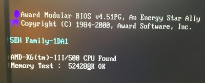

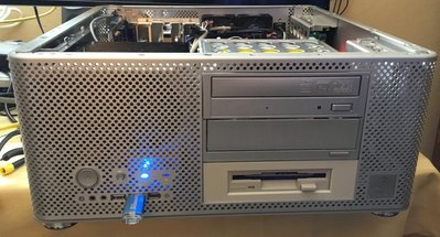

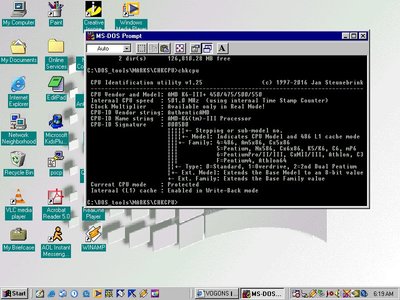

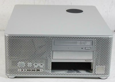

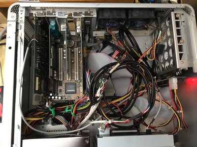

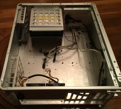

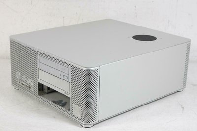

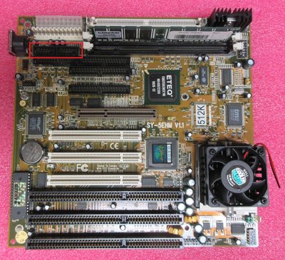

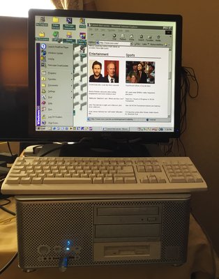

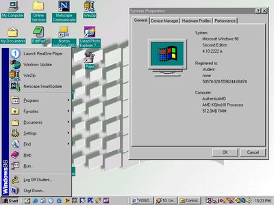

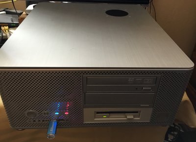

I have been working on this build for about a year slowly gathering up parts in my free time.

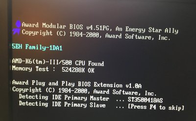

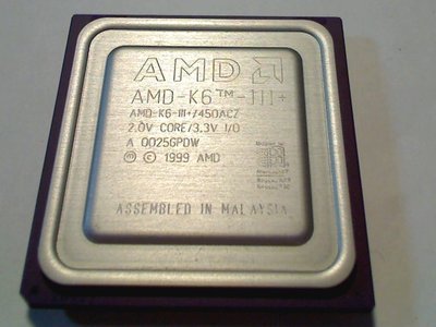

It an AMD K6-3+ @ 450mhz over clocked to 500mhz.
Ultimate retro DOS gaming computer build.
Performs well and is very stable.

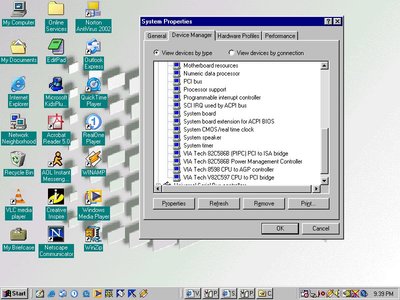

Running Windows 98se. with updates and USB patches.
Motherboard make date September 23, 1998.
Specs:

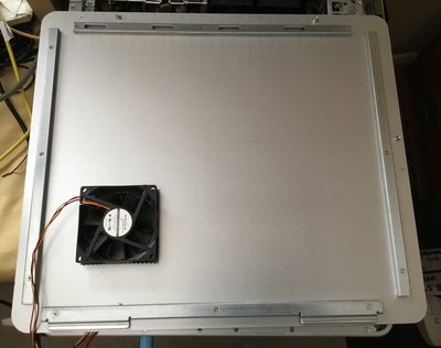

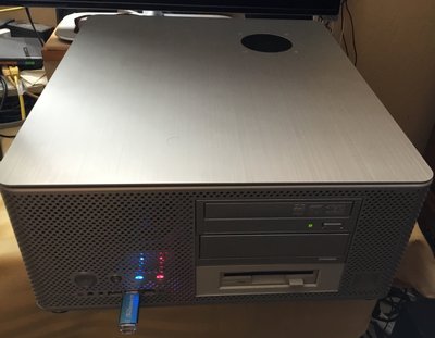

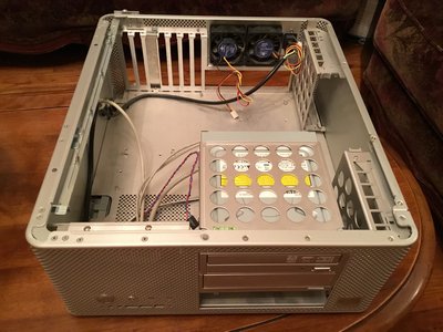

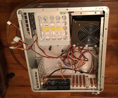

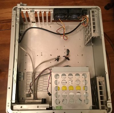

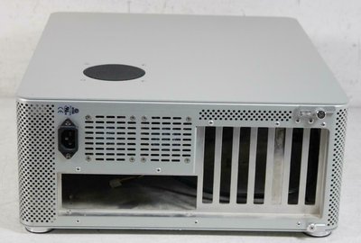

Case - Lian Li Aluminum desktop case. ( PC-V800 ).
Motherboard - Baby AT , Soyo SY-5EHM ver 1.1 ( Super Socket 7 ).
http://www.motherboards.org/files/manuals/107/m5eh20.pdf
Chipset - VIA ( A.K.A.-ETEQ82C663 ).
Cache - 512kb.
CPU- AMD K6-3+ @ 450mhz over clocked to 500mhz. ( 5x100mhz. ), ( Using stock 2.0v )
Memory - 256mb. ( PC-133 ).
Graphics - Voodoo-3-3000 AGP.
Audio - Sound Blaster Live
Network - Digital chipset. 10/100mb. ( PCI ).
Hard-drive - Seagate 72,000rpm 80gb.
Fan Controller - Cooler Master drive-4
PSU - ATX 400 watt.
DVD
USB
Motherboard jumper settings:
100mhz x 5
Voltage - 2.2v
Software:
Windows 98se, SP3, USB patch, I.E.5.5 , AMD K6 CPU Patch.

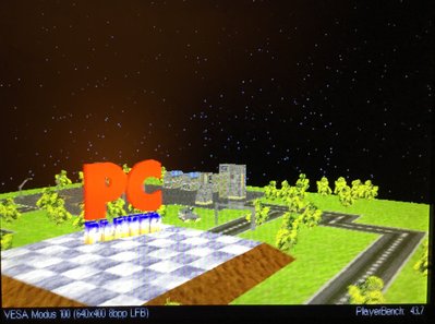

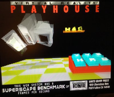

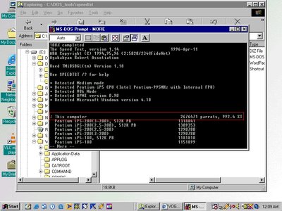

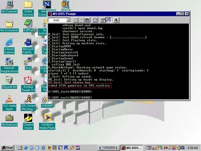

Benchmarks:
3dBench = 365
Speedsys = 2676471 ( twice the speed of a Pentium 200mhz. ).
    122.38 KiB
    4494 views

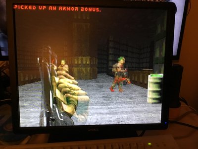

DOOM game test results.
Gametics - 2134 , Realtics - 594

Reply 9 of 43, by miki90
Hey. That's a tremendous build you have going on. I have something similar. The CPU is actually a K6-III+ rather than a K6-III. Much better at overclocking and no issues with caching RAM. Keep us posted on this great build!
Reply 10 of 43, by Intel486dx33
Oh, It is a K6-3+ 450.
I only wish I knew how to set the motherboard jumpers for 550mhz.
But 500mhz. will have to do for now.

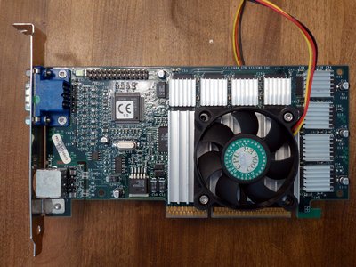

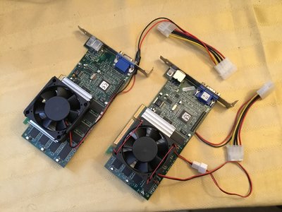

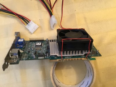

I ordered a 60mm x 20mm cooling fan for the Voodoo-3 that I want to attach before I install the Voodoo-3 card.
These cards run very hot and the heat is a BIG cause of these cards failing. GPU and RAM Solder joints tend to break from over heating.
Philscomputerlab has video about this.

You can however try 600mhz: the 2x multi is seen as 6x with the amd k6-2/k6-3(+) cpus. Also with software you can change multiplier (only with + cpu) so that way you can still get to 5,5x.
Reply 15 of 43, by cyclone3d
Intel486dx33 wrote:
I ordered a 60mm x 20mm cooling fan for the Voodoo-3 that I want to attach before I install the Voodoo-3 card. These cards run v […]
https://www.youtube.com/watch?v=ivxoCzEl9y8
Make sure to replace the ancient heatsink compound as well.
Yamaha XG repository
YMF7x4 Guide
Aopen AW744L II SB-LINK
Reply 16 of 43, by Intel486dx33
cyclone3d wrote:
Actually, The Voodoo-3 card I have has the heatsink glued on and there is no way to remove it unless I try to pry it off and I don't want to attempt that because
I don't want to break the GPU solder ball welds. This is a BIG reason for these GPU's failing is from broken solder ball welds.
So I am just going to attach the fan with plastic ties. Hopefully this should hold well.
The fan is just going to sit on top of the original heatsink. Should provide more than enough cooling.
Something like this photo:
    785.08 KiB
    3894 views

Reply 19 of 43, by Intel486dx33

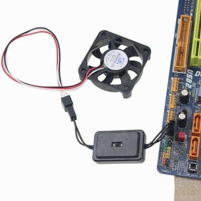

I received the 60mm x 60mm x 20mm fans and attached them to the Voodoo-3-3000 with thin wire that I purchased at the dollar store.
I did not want to screw the fan into the heatsink because I did not want to put tension on the heatsink as the heatsink is glued to the GPU
and the GPU is solder ball welded to the PCB.
and solder ball weld breaks are a major part of the failures in these video cards. Screwing the fan into the heatsink would have resulted in more weight
for the solder ball welds to compensate for.
I am going to add it to the computer now.
I also have a fan speed controller.
https://www.ebay.com/itm/3-Channel-Computer-P … qMAAOSwO~JcrFkb
and
https://www.ebay.com/itm/Small-12V-Motor-3-Pi … e19dbdeb570fa45
60mm x60mm x20mm fan
https://www.ebay.com/itm/12V-60mm-x-20mm-Cool … M4AAOSwD4Rci2VL
