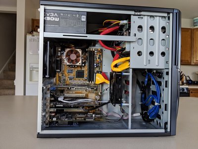

So this was a fun and fairly unnecessary project! The PC on the right has become my retro workhorse. It has the CD drive, floppies, two sound cards plus the intelligent mode MPU401 clone, I'm using System Commander to quad boot different OSes...basically, it's pretty well equipped to handle any bit of retro computing I might "need" to do.
331.47 KiB
2339 views

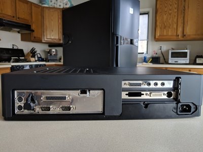

I don't have any romantic attachments to spinning drives so all of my builds utilize SSDs and few have optical drives at this point (with the help of Vogons user doogie, I've spend a lot of time setting up a PXE environment so I can boot any floppy image or install any vintage OS over the LAN). So, with an extra Asus P5A board sitting around, I got to thinking about how far I could slim down a SS7 system to the bare minimum of what I consider important in a retro gaming PC without any filler. For me, this meant the smallest case possible, a video card with good DOS compatibility, an actual ISA sound card with wavetable header, and a NIC card in lieu of any removable media.

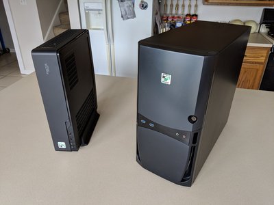

I really like the Fractal Design Node 202 Mini-ITX case for modern builds, so I bought one and started hacking it apart. Here's a random photo of how it's intended to be used with a Mini-ITX mobo and a full sized graphics card:
After a lot of cutting, brainstorming, making stupid mistakes and going back to the drawing board a few times, here is my cluttered end result:
609.15 KiB
2339 views
You may notice lots of strange things like how the SFX PSU had to be rotated in an unintended way in order for the board to clear it, or the fan shroud made of foamcore, or the custom made ISA extension ribbon...I'll post some more pictures detailing the process below but first here are the specs for both systems!
SS7 MID-TOWER:
418.37 KiB
2339 views
Asus P5A rev 1.03
AMD K6-III+ 450Mhz
Single 128MB PC133 CL3
3DFX Voodoo3 3000 AGP
120GB Samsung Evo 850 SSD w/SATA-to-PATA Adapter (DMA Mode)
SB AWE64 Gold ISA (for DOS)
SB Audigy2 ZS (for Win98)
Intelligent Mode MPU401 ISA Clone (MIDI)
DVD/RW Drive (IDE w/SPIDIF CD Audio-Out)
3.5" Floppy Drive
GoTEK 3.5" Floppy Emulator
3Com 3X905C-TXM NIC
Syba SD-V2-5U (NEC 720100 Chipset) PCI USB2 Card
NOTE: All front USB ports work by mounting a USB hub inside the case and connecting it to the inward facing port of the USB2 PCI card!
DOS+WFW311/95/98SE/NT4 (Managed with System Commander 2K)

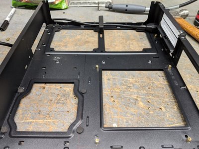

Here is the mini-ITX case after I hacked out some metal and put in my own standoffs for the full sized ATX motherboard:
570.45 KiB
2338 views

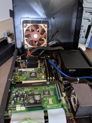

I didn't take a lot of progress pics, but the SFX power supply had to be rotated and screwed to the outside of the case with some plastic standoffs to hold it in just the right place so the board would clear it (the PSU intake fan still sits right over a air filtered vent).

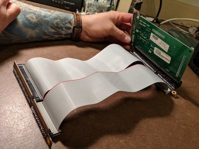

I utilized bus extension ribbons in order to mount the graphics/sound cards perpendicular to the motherboard. PCI extension ribbons are easy to find, but after many hours of searching online I gave up looking for an ISA ribbon and ordered the parts to make one based on information I found in this thread: Short on ISA slots? Try this. . My friend Jason who is more proficient at soldering than I am helped me to create this beast:
437.4 KiB
2337 views

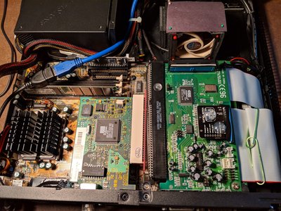

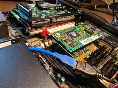

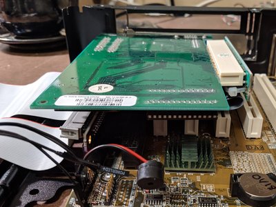

And here is how the cards got mounted into the case. I had to pull a PCI bracket off of another video card that had a video connector that was physically higher up...this allowed the graphics card and sound card to be offset so that the two extension ribbons wouldn't be stacked directly on top of each other. Here's the graphics card mounted offset so the sound card ribbon is able to clear it:
365.91 KiB
2338 views
And then the ISA sound card going in:

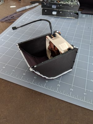

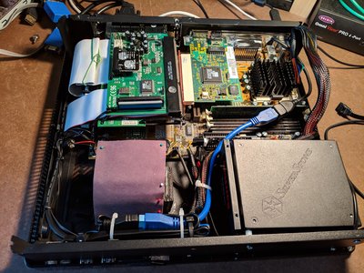

Cooling is definitely a concern which is why I chose the cool running NVidia card as opposed to something like the V3 that I have in my main SS7 rig. I got out my craft supplies and made a little fan shroud out of "foamcore" which is intended to draw cool air in from outside of the case and blow it across the graphics/sound cards.
300.86 KiB
2338 views
Reply 2 of 13, by blougaville
A slim 15mm deep 120mm exhaust fan is mounted on the inside of the case cover directly above the CPU. I haven't done extensive testing yet, but during general usage the CPU is only running a few degrees hotter than the one in the mid-tower case with more conventional cooling.

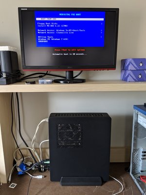

Finally, a picture of me booting off of my network so I can FDISK and start installing 98SE:
306.86 KiB
2335 views
This was super fun and I'm still pretty shocked that not only does it all work, but it seems to be working well and actually feels solid despite looking pretty cluttered in these pictures. I'm definitely inspired to dream up some more small form factor retro PCs and hopefully this post can be of some help to someone else trying to cram parts in a case that they have no business being in.
