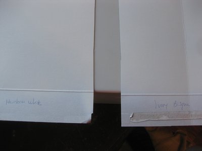

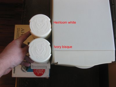

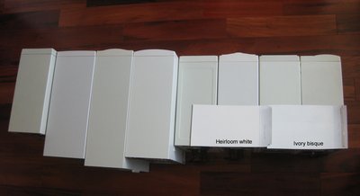

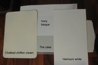

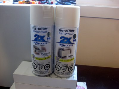

Has anyone sampled the off-the-shelf spray paints to find the ones which best match old computer cases? I have tried Rust-oleum Heirloom white and ivory bisque, both both are a bit too "bright". In one of the photos, I am showing my creamiest tower, but the heirloom white is too biscuit-coloured and bright, while the ivory bisque looks to be of a better match, but still quite a bit too "bright".
It is very difficult to accurately portray colours through the camera/monitor, but from what I tell, it seems that "computer beige" is an ivory colour with a hint of grey-green. Has anyone found a suitable off-the-shelf representation of this colour in a spray can? From the two I have tested, ivory bisque is the closer match, but not close enough. If you look at the second attached photo, you can see the actual case inbetween the ivory bisque and the heirloom white. This case is one of the brighter cases too; it is the 3rd case from the right of the first photo.

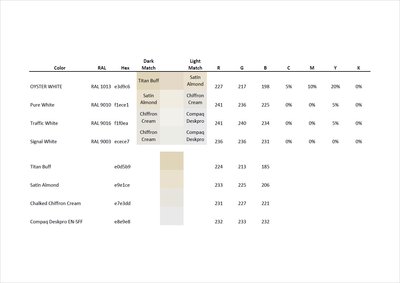

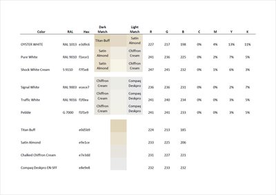

Here's a little comparison I did for some RAL paint codes; I compared them to the three most commonly referred to spray paints on the market as well as the color of my Deskpro EN from my own photographs.
Long story short: Oyster WHite seems to be a good match for the older, really beige 80s to early 90s cases while Signal White seems to be a good match for whiter late 90s to 00s cases.

RAL color codes are universal and you can find these colors manufactured by many brands in places like hardware and auto part stores.
I was looking at Montana Gold sprays the other day as they are very very high quality and have great adherence to plastic even without primer, and I noticed two that are outstanding: Shock White Cream and Pebble.
And with that, I broke down the alternatives into two groups; one for the more almond-like (Y>5%) cases akin to the Amiga 500 and and one for the more white-like cases (Y>5%) akin to the Compaq OEMs and most cases from the Pentium era and onwards.
The file is attached below.
I feel like RAL1013 for those almond cases and RAL 9003 for the whiter cases are mostly spot on. It also happens to be that I actually have a can of RAL 1013 at home, and Iplaced an order for a RAL 9003, so I will spray them side by side onto cardboard and lay them on a couple of cases I have around, and post photos of the comparisons next week.

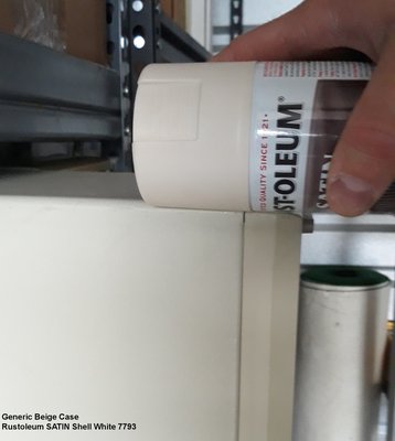

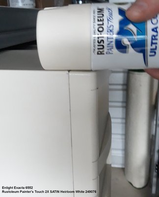

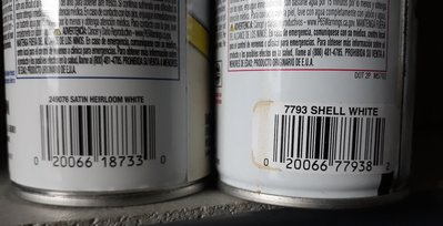

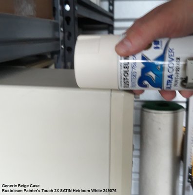

These are the two closest colors I could find (available) that match. I purchased a can of Krylon Satin Ivory tonight, but I will have to wait until the weather improves to see how well it matches to my generic beige cases. The Heirloom White seems pretty close to the Enlight Exacta 6552 case; Krylon Satin Ivory is just a hint darker, and tinge biscuity than the Heirloom White.

I picked up the chalked chiffon cream today. Attached are the results. If you are trying to matched a yellowed ABS bezel, the chiffon cream might work for you. I'd rather retrobrite the bezel and find the original metal case colour though.
