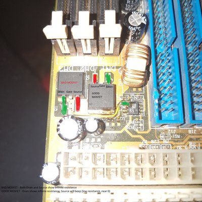

>the only thing you should measure is drain-source junction
while in circuit, powered down, in diode multimeter mode, both directions
low resistance gate-source can mean blown LX1682, would result in same symptoms, testing will require desoldering to check

Here's a photo of what I mean. Explanation on the bottom of the picture.
    1.35 MiB
    324 views

your pinout is wrong, your conclusions are wrong, pin 1 is gate
I get infinite resistance on all FETs when I do that.
