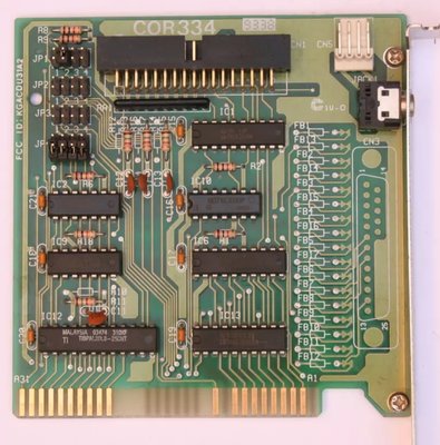

This is the ISA cdrom controller that came with my Sony 2x cdrom.
It’s a model # COR334
I had a ISA sound blaster 16 for a sound card.
Should work vanilla with Win3x, NT351, 95/98
Or any DOS boot floppy with CDROM support
You will need to load the CDROM driver MSCDEX in DOS. AUTOEXEC.bat and CONFIG.sys
https://archive.org/details/cd-driver-1.25

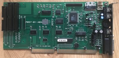

i have found a music card with the needed interface. Will try it soon. BTW - is this something of good quality or a crap (taking early 90s into account)?
