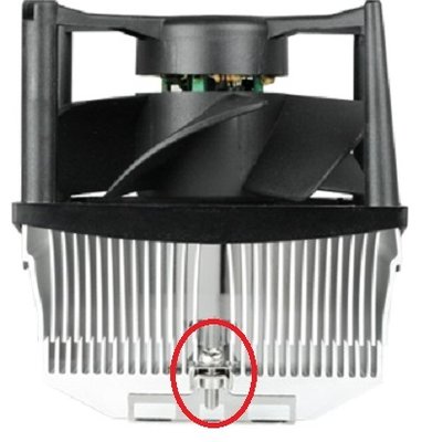

Hey I’m somewhat new to old hardware builds, wanting to make sure I do it right. (Builds log coming soon!)
Was wondering if anyone had a cooler they suggest rocking on one of these modded Tualatin without harming anything, I know it’s slightly thicker so wanted to pop in before I get a random one.

Whilst most coolers will probably fit OK, I think a favourite here would be something like the Arctic Cooling Copper Silent 3 which, as well as a decent heatsink and fan, has a screw-adjustable tension clip (highlighted), and if you don't like the fan style you can change it easily for an 80mm of your choice.

PC Hoarder Patrol is spot on with that cooler suggestion. I use the exact same CPU and adaptor board as yourself with The AC Copper Silent 3 and it works great.

I've used a Spire WhisperRock IV, the aforementioned Copper Silent III, a waterblock and even forced a couple of stock coolers onto those modded tualatins. Realistically you should be fine with any option, feasibly the larger coolers with the longer mounting brackets, or adjustable mounting brackets will be much better.

Another option might be the Akasa AK-786, which is still widely available, slightly smaller 70mm fan, but retains the preferable 6-point clip with a lever-based tension mechanism.

I would just bend the clip so there slightly is less pressure.

This is what I ended up doing with a NOS Cooler Master.

Yep worked fine! Going to replace the fan with a Noctua and be on my way.
