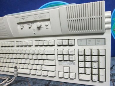

I picked up one of those nifty old Intergraph keyboards with the built in speakers recently and I just attempted to test it. The keyboard works fine and feels pretty decent, but there is no sound coming from the speakers at all. The switches all seem to change the lights as expected (switching it on, switching between stereo and SRS mode, hitting mute, etc). The power LED does flicker once when I turn it on... like, it'll come on and go dim briefly, then come back on and stay on. It does this pretty much every time I switch it on. There is absolutely no hiss, pop, crackle or hum of any kind coming from the speakers, even when switching on or playing with the volume control.
My ability to diagnose things like this is pretty limited, but I did a few basic things. First, I opened it up and checked it out and it looks very nice inside. It was really dusty in the key-area but in the enclosed area for the amplifier circuitry it is clean. There's no sign of any capacitor leakage, burnt\broken traces, overheated components, etc. Using my DMM I checked the speakers and they are both showing 7.6ohms, so they should be fine. I checked continuity from the three points on the 3.5mm audio input jack to the three pins at the other end inside the keyboard and it seems perfect so the cable is intact. I've tried powering it via they keyboard port (it has an adapter for this) as well as powering it with a 12v power brick that I know works and it made no difference (it also does not change the power LED dimming before turning on). The label on the back of the keyboard says it expects a 9v power brick but the actual documentation says 9-12v input and the TEA2025B can handle from 3v to 15v, so a 12v brick should be fine (and it was the only one that fit). The polarity is also correct. I also tried cleaning out the volume pot with deoxit D5 because it was really sticky sounding, almost like there was a ton of grease inside it. I'm not sure if this is intentional or not, but I figured it was possible that any grease added to make it feel smooth could have gotten into the pot eventually and stopped it from working. It now turns very smoothly and silently but there's still no sound from the speakers.

Other than the optional SRS circuitry (its on a separate board and is likely only used if SRS is switched on) it uses almost entirely passive components. If the TEA2025B was bad, how would I go about testing it?

EDIT: I just tested the microphone on the keyboard and it works fine. I also tested the headphone output and subwoofer output and they both appear to be passing audio through from the 3.5mm input jack as expected (as long as the power switch is turned on). I wonder if that amp is toast or if some of the caps have gone totally out of spec. I've used equipment far older than this and not had these problems, but then I'm not familiar with mid-90s era ELNA capacitors.

Okay, I just did some measurements. I have no idea what these mean, but here is what I measured:
VS+= 13.3
Out.1= 6.4
Boot.1= 13.3
Feedback= .518
In.1= .002
Bridge= 0.064
Out.2= 6.4
Boot.2= 13.3
Feedback=0.518
IN.2= .002
SVR= 12.2
I measured the 12v input pins (coming from the power adapter, going into the amp board) and it is 13.4v.

It's probably a safe bet the amp chip is good if the headphone jack is functional. Have you tried checking the speakers themselves to make sure there not dead

I've been trying to do this, but it's proving to be quite a bit more complicated than I thought. There's... just nothing. Nothing connecting anything to the speakers. I have no idea how. All of the speaker connections on the right-side pin block seem to congregate at the headphone jack, but the signal isn't coming back OUT. This would make sense if there was some kind of auto-sensing deal with the headphone jack, but there's nothing plugged into it...
... wait! Maybe that's the problem? Maybe the jack is messed up. Which would explain why it actually works for headphones but I get no output at all from the speakers.
Let me see...

I got it!
I had a paperclip with a very short, 90 degree bend in it that I'd "made" a while back for a specific purpose. I put it into the headphone jack and used it to pull the two pins (one on either side) away, in the opposite direction that a plug would push them. I pulled them away a little bit, tested two pins for continuity (right speaker and right headphone) and sure enough, they finally had continuity! When I powered the unit on, the speakers gave a slight bump and I knew it was finally fixed. I just tested it with my phone and the speakers sound really good considering they're built into a PC keyboard. I don't know how reliable this will be if I intend to use headphones periodically, but it works now! Now that I think about it, this fix could be done with the unit completely assembled since I did it from the outside of the jack. I'll probably test the jack a couple times and if it does it again I'll just tug the contacts in a bit more. If I can get it to hold up to a few insertions of the jack, I'll put it all back together and call it good. If it happens later I can do the same thing with it fully assembled. If it keeps happening... eh... if I ever find a similar jack (not likely... they're long, flat and a bit odd looking) I can replace it, but I got this keyboard for $18 shipped, so I'm not going to go to crazy with it.
Thank you again for the help!
EDIT: Still seems a bit touchy. Basically, every time I insert a plug into the jack it stops the speakers from working until I use something to pull the tab back out again. It appears to be the tab on the right side of the jack (if looking at it from the front). I'd dismantle it to see if I could fix it, but without a replacement I'd be worried that I'd break it permanently.

I have totally forgotten about the thread. I have missed the headphones working part so that changes everything and the problem is entirely mechanical as you have found out now.
Only good solution is to bypass or replace the headphone connector. Bending pins back to shape or cleaning them usually doesn't provide a lasting solution.
