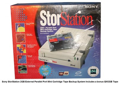

I'd be amazed if it didn't 😀 - recognise this?
266.69 KiB
412 views
Also, https://www.thefreelibrary.com/Sony+StorStati … ket.-a018775743

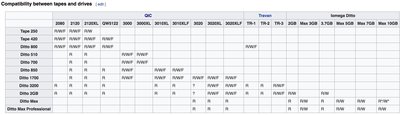

it is not so easy...
https://en.wikipedia.org/wiki/Ditto_(drive)
DITTO 2GB can R only some of the QIC tapes, 3020xl/f can be R/W, what is strange it can R/W 3.7GB tape even it is only 2GB drive?

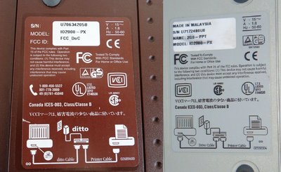

I saw that table too, but the point I'm making is that the DITTO 2GB format was a joint development between IOMEGA & Sony (as detailed in the previously posted Free Library article link) and that their respective units are identical, save for individual company branding. To emphasize that point look at the labels on the bottom of their external models (IOMEGA on the left and Sony on the right);
406.37 KiB
365 views
aside from the near identical labels, they're both model IO2000-PX.
I'm as certain as I can be that the pre-formatted Sony tapes I mentioned earlier - QW2GB - will work fine in an IOMEGA-branded unit, and they seem available cheaply enough to be worth a try, but the choice is yours.
I think the only marketing difference is that IOMEGA made an internal & external DITTO 2GB but Sony (possibly) only made an external version of their StorStaion DITTO 2GB.
