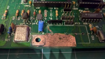

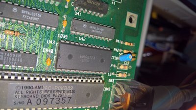

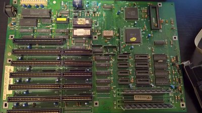

Few months ago I bought this AUVA 286 (BAM/16) motherboard. I had extensive battery leak dammage, but it was in running condition. I neutralized the leak and fixed the dammaged traces. Motherboard runs fine, but RTC is like three times too fast (it counts 3-4 second every second). I don't see any dammage around RTC chip.
https://youtu.be/KPGeonVL-PI
What can cause such behaviour? Dammaged RTC chip?

Reply 1 of 2, by rasz_pl
is c13 cracked? you might need to resolder/replace y5 "watch" crystal
still plenty of green corrosion on the legs of components

Reply 2 of 2, by HanJammer
Yeah, it seems so - C13 is cracked. I havn't noticed it before… I will replace it. Also the cap next to this one literally turned into dust when I touched it.
Y5 sits tight on it's spot, so unless it's internally dammaged I will leave it alone (I doubt there is a connection problem I will verify it later).
Yeah I may try cleaning this board a little more...
