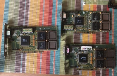

Made a bunch of upgrades today.
It all started with me getting a cheap Pentium MMX machine that came with a Tseng ET6000 with a couple of socketable MDRAM chips. This presented me with a dilemma:
1.95 MiB
782 views
I have two ET6000s (well, actually three, but the third one doesn't have any RAM). One has socketed MDRAM chips and the other has them soldered. I also have a ET6100 with two socketed chips. All of them are MD908 (1MB per chip), not MD909 (1.125MB per chip). So I've decided to switch to ET6100 and upgrade to 4 megs of RAM. AFAIK this shouldn't give me any benefit apart from being able to use higher resolutions. The issue is that ET6100 used to have issues with RAM and it showed me 1 meg of RAM instead of 2. I've removed all the chips, checked their legs and cleaned them. Now I supposedly have 4 megs of RAM. Any tool to check the video memory? I've ran a bunch of DOS graphics benchmarks with no issues though.
Okay, no I have a kickass 2D card, but I should probably get something for 3D. I've considered Voodoo 1, Voodoo 2 and ended up sticking two of those:

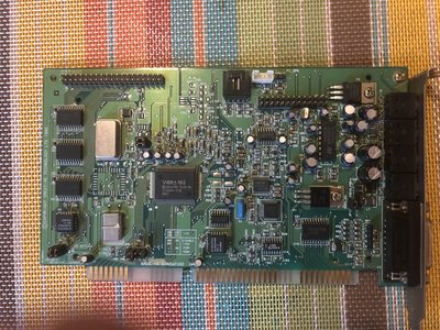

Finally I've decided to add an SB16-compatible card:
1.95 MiB
782 views
It's a Vibra CT2900. It has true OPL3 (I want to run AdLib Tracker on it) and is supposed to have the cleanest sound output. Also unlike my CT2940 it has at least some jumpers (for the CD headers). I don't intend to use this card for MIDI, so I don't care about the hanging note bug.
And just like this, my DOS machine turned into a fairly powerful early Windows 9x system, capable of playing games like Quake 2, Daikatana, Half-Life and Unreal. I specifically plan to try Daikatana 1.3 with WickedGL and try out some Doom sourceports with OpenGL support.

- Got SB16 to work under Win95's DOS mode. Turns out, you need not only 95dosapp package, but also CTCM. The installer doesn't work, so you just need to unpack it and modify the autoexec.bat. Wonder why they didn't include that into 95dosapp in the first place.
- Apparently, Tseng ET6100 sees all the 4 megs of RAM. I've tried switching Windows to 1600x1200@16 bit — the maximum resolution ET6100 supports. It's too small to use, but it works. Final Reality and 3DMark 99 still think I have no DirectX-capable card though.
