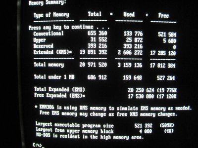

My 486 computer is already having 20mb ram but still it's nightmare trying to get enough free conventional memory. I already ran memmaker and put things into high but still I am getting only 509K of free conventional memory while there's at least one game requiring 570K. The computer is equipped with plug&play but there's nothing configurable in bios settings so I have to use dos manager for my SB16 plug&play soundcard.

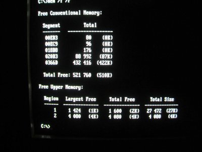

Reply 1 of 22, by Deksor
Can you run mem /c /p and mem /f /p and show the results to us ? This will be helpful ^^

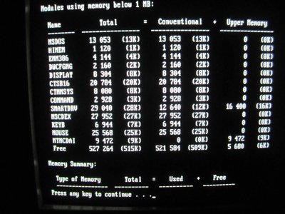

Reply 3 of 22, by musicforlife
Here they are:

Reply 6 of 22, by dionb
Given that SMARTDRV is eating most of your upper memory, you could ditch that which would let you run a lot of the other driver stuff there, freeing up between 15-20k of conventional memory.

Reply 12 of 22, by luckybob
MOUSE is using 25K of ram
Switch to CTMOUSE, it uses ~3.5K of upper memory
http://cutemouse.sourceforge.net/
Thats 25k for ya there!
Also switch MSCDEX to SHSUCDX. It even lets you use ISO images for CD's. http://adoxa.altervista.org/shsucdx/ it uses 11k of upper memory and zero conventional. thats another ~27k

Reply 19 of 22, by dr_st
musicforlife wrote:
I know I could get it better with third party programs (JemmEX, Cutemouse etc) but I originally wanted to have "authentic" setup with original stuff of the time 1994-95.
Enjoy banging your head against a wall, then. 😀
Other than that, your startup files have the following problems:
1. Loading device drivers that you probably don't need and loading them low.
2. Not using proper EMM386 switches (the monochrome region I=B000-B7FF and 'dead ROM' I=F000-F7FF can probably free a lot of UMBs)
retardware wrote:
The same with FILESHIGH, BUFFERSHIGH etc after HIMEM.SYS in config.sys.
So OP can allocate a sufficient number of files.
8 is a joke, 🤣. I generally set 60.
FILESHIGH, BUFFERSHIGH etc do not work in DOS 6, AFAIR. But yes, setting FILES, BUFFERS, STACKS too low will cause various issues with many games/applications.
