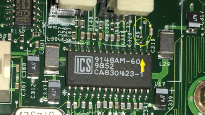

This motherboard definitely uses BX chipset and should push beyond 100MHz FSB, but according to the sticker instructions, motherboard is a 66MHz FSB variant. Perhaps IBM, instead of designing a cheaper EX based motherboard, simply modified existing BX for entry level segment?
Write down PLL ICs model ("ICS", below DIMM slots), now it's the only performance limiting factor in that motherboard.

this is the ICS:
https://drive.google.com/file/d/1pAg2XRyGtbcu … ew?usp=drivesdk

Reply 26 of 42, by SSTV2
Here's PLLs datasheet, pin 16 selects between 66 and 100MHz FSB (see pg. 2).
Pin 16 pulled to ground (L) - 66MHz, pulled up (H) - 100MHz.
Remove motherboard from case and try to trace where it goes, it can be permanently connected to ground, if not, it could go to slot1 "BSEL" pin, in that case CPU FSB is selected automatically by CPU. This PLL has i2c bus and can programically set FSB up to 133MHz (see pg. 4, "Byte3" table).

Reply 35 of 42, by SSTV2
You have to figure out the schematic of pin 16 of "ICS" PLL. It's probably permanently tied to ground and no CPU would bring that pin up to the Vcc of 3.3V (H). Maybe there is a simple 0 Ohm resistor or jumper that connects pin 16 to ground, in that case, all you'd need to do would be removing it and connecting 10k Ohm resistor from 3.3V to that pin.

Looking at the PCB near pin 16, you can notice that a resistor marked "R149" is missing, maybe all you'd need to do to enable automatic FSB detection would be installing it. The mod should not be too hard, knowing that exact same motherboard PCB was used for 100MHz motherboard variant.

Reply 39 of 42, by SSTV2
It might be just one of the steps. Measure for continuity between pin 20 (3.3V Vcc) and via that would connect to R149, if multimeter shows that it is a common node, then R149 is a pull up resistor. Measure for continuity between pin 19 (or any ground point) and pin 16, repeat measurements with and without CPU (try PII with 66MHz and 100MHz FSB), see what happens. I think that pin 16 might still go to "BSEL" pin of slot 1, if both 66/100MHz FSB CPUs do not change the readings, then it's permanenty connected to ground (I presume).
