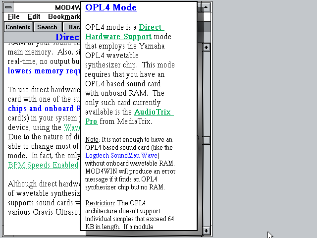

Thanks for the feedback leileilol! This reminds me a bit of the OPL4 chip.. ^^
MOD4WIN had native support for it, albeit that chip had a sample size limit of 64KB each.
Provided that Sample-RAM was installed at all. Cheap OPL4 cards only had the General MIDI ROM connected..
