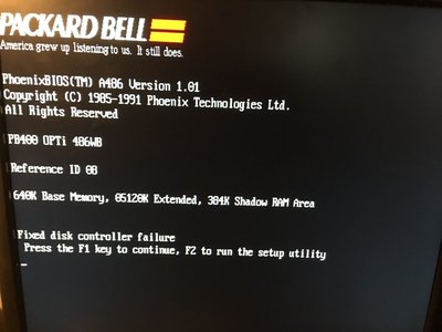

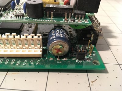

Hi all. I've got a PB Legend 610 486 SX-25. The NiCad battery began to leak, so I swapped it out with a NiMH battery of the same voltage and fit. The machine worked well for a few months, until it very recently began showing a "fixed disk controller failure" on boot. I've tried several different drives with the board, and all of them produce this error message regardless of the disk geometry settings in BIOS.

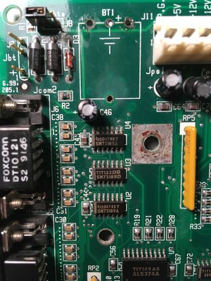

So I ordered a replacement board from eBay. This one arrived with battery leakage corrosion, which I cleaned up. It has *exactly the same* disk controller failure as my original board. What are the chances both boards suffer the exact same failure?

Reply 1 of 11, by dionb
"Disk controller failure" can be as simple as incorrect CHS settings (due to loss of CMOS data) or a dead/dying HDD. What happens if you attach the same drive with the same settings to a different system?
Reply 3 of 11, by vga256
Thanks for the ideas so far. Just tested the drive (Seagate ST3120A) in my Pentium 100, and it works fine with the same CHS settings and IDE cable.
Any other ideas on figuring out the source of the controller error on my PB400 board?

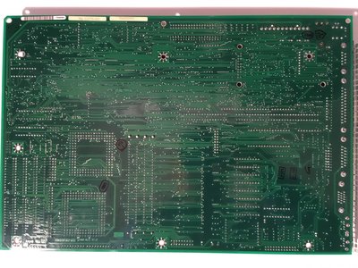

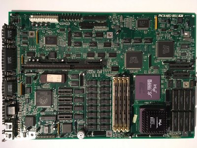

A few pics of the motherboard:
1.17 MiB
1069 views
Top side of board
914.1 KiB
1069 views
Underside of board
695.17 KiB
1069 views
Battery location and corrosion
Reply 8 of 11, by vga256
FWIW, I sold this board to someone with better soldering skills than I - he repaired several corroded traces on the PCB due to the leaky battery. It took him days to figure out where the traces were broken.
