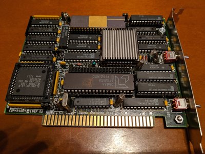

All right, since I'm having some technical difficulties with the card at the moment, I figured I'd take it out, snap some pics, and drop as much info as I can. First up is a primary shot of the board:
1.79 MiB
1477 views
Main board shot.
First row of IC's on the left are as follows:
SN74LS373N - FFAY9006 (octal transparent latch)
Sony 7K08 - CXK5461P-45L (X 4) (cache RAM?)
Edsun Labs EL286-88-10-B - M73V001 - 7Z03 (8088 to 286 signal converter)
The vertical IC between the first and second columns is marked SP8942 - DM74ALS373N (Differently branded octal transparent latch)
That second vertical column of IC's includes two more SN74LS373N - FFAY9006 chips and one SN74LS547NS - 824184. Looks like another latch.
The two IC's near the ISA connector include yet another SN74LS547NS and a &4LS374N - FGK5758 - 9001VF. The crystal in that area is labeled PLE - SRMP18 - 24.000 - 8938.
In the last column I see two socketed chips, four soldered IC's, and one more socketed chip at the top of the board. The four soldered IC's include MC74F521N - XXEE9009, MC74F244N - XXGJ9003, and two Sony 8G01 - CXK5416P-35L.
Those last three socketed chips are probably of the most interest to us. It's three PAL chips. PAL20R4BCNS - 005FCD3 - TW-30, PAL20L8ACNS - 001D9UZ - TW-20, and PAL20L8ACNS - 001D9UZ - TW-10.
There's also the obvious 80286, the 8088, and 80287 sockets. The 8088 installed was pulled from my 5160, the total bitch of an LCC socket holds an AMD 80286-16S, and the 80287 socket has a 287XL purchased off eBay.
The board has jumpers for 6 MHz, 8 Mhz, and 10 Mhz 80287 operation. I've stuck a 287XL in there, which I've read handles multipliers differently than a regular 80287, such that it should undo a 2/3 multiplier that most motherboards implemented on the 80287/8087 socket. Haven't been able to test due to some oddities with the board, but we'll get to that.
So, when I bought the board, I could flip the switches off to go straight to 8088 mode at boot. If I flipped the switch for 286 operation, it would hang with no screen output. Turns out the EL286-88-10-B was not properly seated, so gentle application of the thumb fixed that. TopBench showed that in 286 mode with the cache disabled, we were hitting speeds of a NEC V20 at 4.77 Mhz. When I flipped the cache switch on (and rebooted) we hit the speed of an 8088 at 10 MHz. The 286 will not hit full speed until about two minutes after boot, at which point TopBench shows a jump from a score of 4 to the highscore of 10. This was enough to run Number Munchers comfortably. Same goes for the Ultima remake from 1986. However, Ultima II with the upgrade patch failed to start and said something along the lines of the executable being damaged. The Ultima III upgrade patch ran way too slowly, whereas the unpatched executable ran just fine. I guess all that newfangled hacking needs just a little more power to keep things smooth.

All right, I think that's enough of my adventures and basic analysis of this board. Should we move on to cloning, improving, and wish listing?
First, I know those three PAL chips need to be read and reproduced. Hardware in general isn't quite my forte, and reverse-engineering stuff even less so. If anyone thinks these can be read, let me know how we should approach it.

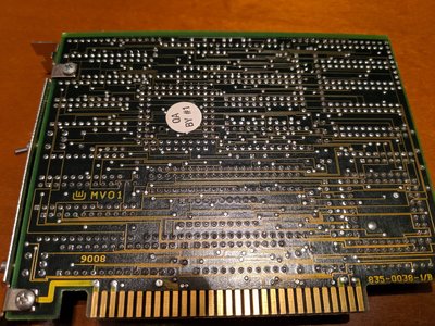

Next up would be new board redesign. Obviously we'd need some better shops of the top side of the board, with all of its horrendously squashed component placement. For now, here's an OK shot of the rear of the board.
