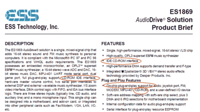

Reply 41 of 44, by Jo22
user33331 wrote:
CD-drive gives an error similar like: "unable to load driver", "no driver found".
What is the driver for ESS 1869F IDE CD-driver ? ( Oakcdrom is probably a different sound card ? )
I'm sorry, I don't understand. I'm confused.
Maybe your cards has a special IDE port that needs an enabler utility, okay. I accept that fact, but..
https://www.philscomputerlab.com/ess-audiodrive-es1868.html says this type of soundcard has a bog-standard IDE/ATAPI interface.
The datasheets for your model says the same. LINK
Oakcdrom.sys does usually work with any IDE/ATAPI compatible interface and any IDE/ATAPI compatible CD-ROM drive.
That's why Microsoft made it the default IDE/ATAPI CD-ROM driver of the Windows 98 Setup CD.

Reply 42 of 44, by user33331
Where is a reliable place to download OAKCDROM.SYS ?
( Or is it a default program too in Dos6.22 and/or Win3.1 ? )
CONFIG.SYS
DEVICE=C:\ES1868.COM /A:170 /I:9 ( ENABLE IDE-PORT )
DEVICE=C:\DOS\OAKCDROM.SYS /D:MSCD001 ( CD-ROM DRIVER )
AUTOEXEC.BAT
C:\DOS\MSCDEX.EXE /D:MSCD001 /V /L:D ( START D:\ DRIVE )
/V = Verbose mode.
/L:D = Set drive to "D".
+ If I have 2 pcs CD-Rom drives how to input both D:\, E:\, Master and Slave ?
1st CD-drive master D:\.
2nd CD-drive slave E:\.
DEVICE=C:\DOS\oakcdrom.sys /D:mscd001
DEVICE=C:\DOS\oakcdrom.sys /E:mscd002
C:\DOS\MSCDEX.EXE /D:mscd001 /L:D
C:\DOS\MSCDEX.EXE /E:mscd002 /L:E
Thanks
