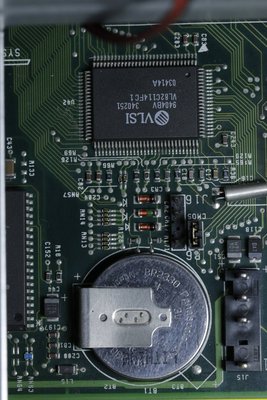

Reply 2 of 11, by Ultrax
Here are the photos. The board was quite dusty, but I did my best to dust everything off without an air compressor. This motherboard belongs to a 433 that was destroyed in shipping. I have a 425, but the motherboard in the 433 is the same as the 460 so why not. (Plus, I don't feel like dissecting my precious 425 at the moment, 🤣.)
If the corrosion is too bad, I would advise getting a new motherboard entirely. Corrosion is definitely repairable sometimes, but it can (and often does) eat the traces of the PCB.

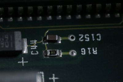

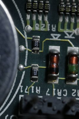

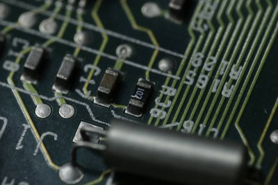

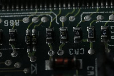

Reply 10 of 11, by Elanus
k3x1s wrote:
Everybody thanks for replies! We washed motherbpard in distilled water and cleaned by ethanol with toothbrush. Photos was made a […]
Everybody thanks for replies! We washed motherbpard in distilled water and cleaned by ethanol with toothbrush. Photos was made after this.
Resistors from picture fell off and we replaces by resistors from another motherboard. But few of them randomly. Because we didnt know number of original one.
Computer turning on but black screen and hdd not launching with connected IDE. If IDE disconnected then hdd powering on.
Ultrax, we still waiting you 😀 And thank you for your help!
I have a 433 too, Im taking some macro-shots of this area today, to help with the numbers
Here are the pics:
