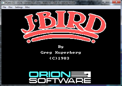

...I made another ROM. This time it contains a CGA game I played for hours when I was young 😉 I had this game as copy of a copy-protected 360kb-floppy. This floppy needed to be booted, therefore no DOS-functions are used, only BIOS-calls.
Later I found a version on the internet where the copy-protection was removed and you could run the game from DOS. I saw its size is only 61 kb.
Therefore I took the chance and put it on a ROM to turn your PC in an arcade machine. As it doesnt run directly from ROM the loader copies its content to RAM 1000:0 (therefore not much RAM needed) and executes afterwards.
The game is fun, maybe some of you dont know it 😉
If there is some interest I can also include some kind of selector so the ROM is only started when e.g. a key is pressed.
File is provided as a single 64 KB image or 32 KB HI/LO images.

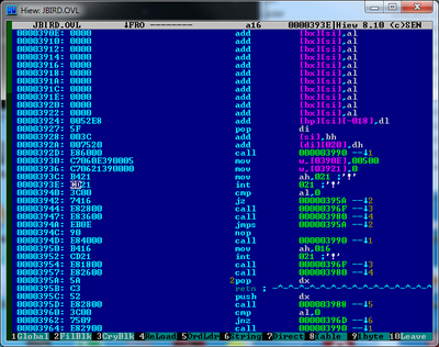

Reply 5 of 16, by Tronix
Game uses int21h calls for load or create SCORE file. AMI 286 BIOS fill all unused interrupts with dummy calls, but some XT's BIOSes - not. So, if add dummy int21h handler to loader, game start on XT very well. I tested with PCem. ROM start from D000:0000.

Now the interesting question: How did you get this running with PCem...? And how did you find out about the int21? I only tested in my AMI-286 so far. Think never would have found out that the int21 is the reason why it crashes on other machines...

To search int 21h calls I used HIEW32. Load JBIRD.OVL, F7 (search) then F7 - search by assembler command - enter "int 21h" and look at search result:
