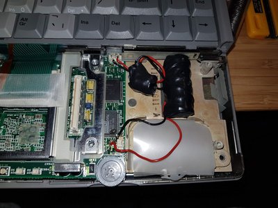

Opened it up, took out the batteries. They are not leaking but the big one has a cell that's bursting. I'd like to replace them but when I search Google I just come up with one hit from a company in Washington state. I may be using the wrong keywords? Anyone have a tip on what to search for when I want a replacement battery for these?
Reply 7 of 7, by Thermalwrong
You could try doing what I did - I had the same corrosion coming from the RTC and standby batteries, which had unfortunately rotted the cables and their connectors entirely, but mostly stopped at the battery connectors on the board.
690.09 KiB
202 views
These are simple tagged cells, I just used cells of matching voltage and milliamp hours, I think 7.2v and 80mah for the bigger of the two. So you might find suitable replacements just by searching the voltage and exact or similar mah values (in tens).
The standby battery I think you can just skip. You can find proper replacements just by searching for a toshiba RTC battery or toshiba 2.4v / 3.6v
