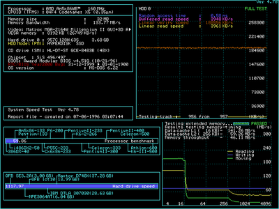

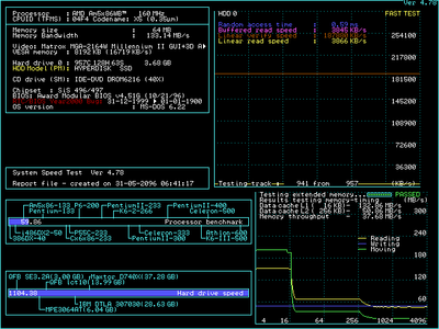

So apparently on a 486 EDO/FPM does not matter.
Well FPM looks to be slightly faster writing..
Also system is not stable with edo. (Random crashing/Random ram sizes with cold boot)
EDO ram was tested with memtest4 on a pentium 133
FPM was tested on the 486
The system is a Lucky Star 486 Rev D.
16.84 KiB
312 views
486 Edo Result
17.04 KiB
312 views
486 FPM Result
    486EDO.TXT
    4.49 KiB
    10 downloads
    LS486FPM.TXT
    4.62 KiB
    9 downloads

There is the SIS496/497 newest revision (PR) that is stable with EDO RAM but the performance not better then with FPM because SIS496/497 isn't optimized for advantage of EDO memory.

Depends on chipset/BIOS. There was a thread recently with different BIOS images for the Shuttle Hot-433 which I tried on my board. One of them contains an option to enable faster timing for EDO and it allows 3-1-1-1 at 33MHz and 4-2-2-2 at 60MHz (Cyrix 5x86 at 60MHz times 2). At 40MHz there was no benefit though, even a slight loss.
This is the only time I've seen an explicit option for EDO, and this particular BIOS has other problems: several of the settings have no effect at all and the L2 timing is permanently stuck at 2-1-1-1 (can't even be enabled at higher bus speeds).
Aren't there some other boards with UMC 888x chipset? Maybe after all these years we still need some BIOS hacking to unlock the full potential of these boards.
I got these results for memory read with the Cyrix 5x86:
33*3 FPM (0 wait) - 45MB/s
33*3 EDO (3-1-1-1) - 62MB/s
40*3 FPM (0 wait) - 54MB/s
40*3 EDO (4-2-2-2) - 50MB/s
60*2 FPM (1 wait) - 60MB/s
60*2 EDO (4-2-2-2) - 75MB/s
