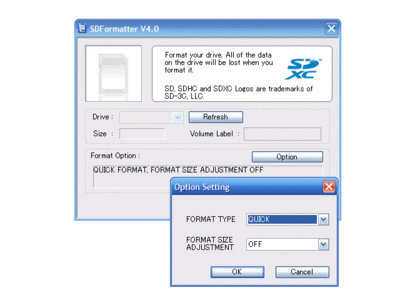

You can try to use SDFormatter v4 to format flash media and see if this improves disk performance.
Unlike Windows/DOS, it knows how to properly format SD cards (and thus, maybe CF cards, too).
