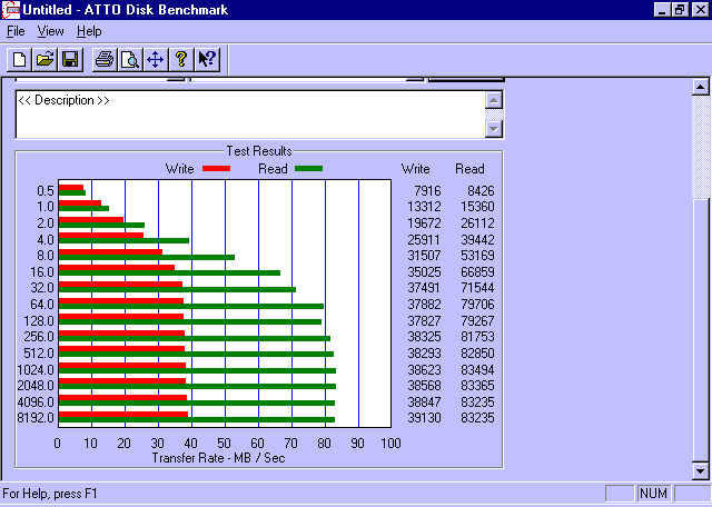

Reply 85 of 346, by mockingbird
Ok well here's the short and long if it:
In short, yes the 686B works, and unlike the VT6421A, it passes TRIM. And for the long of it:
Well, first of all, Windows 98 proved once again that a preliminary Prime95 run under a Linux floppy micro-distro is no substitute for a proper stability test... My mobile 2400+ is not in fact stable at 2133 at 1.55 volts. I just lowered the FSB to 100Mhz instead of experimenting with it at this time, so I could get on with my testing. I may purchase a mobile 2500+ in the near future.
Now, while the 686B does work fine with the aforementioned combo, it does not do so without a caveat or shall we say altogether well. These screenshots speak for themselves (sorry that they're GIFs, I was limited to the primitive conversion filters in 9x MS Paint):
Marvell controller with ICH2:
11.25 KiB
1058 views
Marvell controller with 686B:
11.59 KiB
1058 views
So the 686B has only half of the write performance to that of the ICH2 in this scenario.
Still, I would personally rather use the 686B than an add-in Promise Ultra133TX2, simply because it is generally always better to use the native implementation than it is to use an add-in card, and the speed is still quite acceptable (and not to mention, the read speed is perfectly fine, only the write speed is affected).
VIA 4.43 was installed, and DMA was enabled.
But I'm going with the P4 system over the KT7A, simply because ODCM throttling is so good, the KT7A simply cannot compare with its flexibility in that regard. And my P4 board has SB-Link, so I'm covered there.
(Decommissioned:)

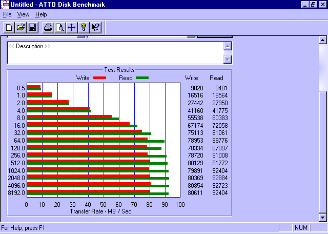

Reply 86 of 346, by cde
This disrepancy between read and write speeds is interesting. On my KT7A, using the Marvell 88SA8052-based mSATA to 2.5" PATA bridge, plus a 2.5" to 3.5" adapter, and a Transcend 128 GB mSATA drive, I get roughly the same read and write speeds, but it tops at 50 MB/s, even though in theory UltraDMA 100 is used (according to the BIOS and Linux kernel log). These speeds are consistent across Win98/XP and Linux.
    9.99 KiB
    1043 views

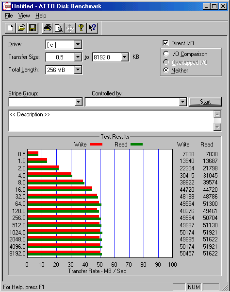

Reply 87 of 346, by mockingbird
cde wrote on 2022-02-03, 13:34:
You know, it might be this decades-old IDE 40pin to 44pin adapter that's causing the issues with the Ableconn adapter (it also has the same mouse jerkiness on the 686B)... A new one is on its way in the mail... Will report back.
Your results do look good by the way, but it seems like you're being limited to UDMA66 instead of UDMA100 (despite what you're being shown by the display with regard to that setting). Which controller does your Transcend module use?
Also, the stability issues were caused by a PC133 module that was randomly picked out of a pile for this particular test that happens not to actually work at 133Mhz... Replacing it with a Hynix module fixed everything, and the CPU is indeed stable at 1.55V @ 2133Mhz.
(Decommissioned:)
