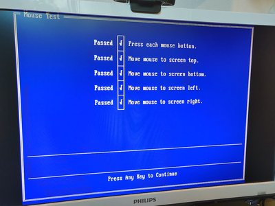

I am happy to report the card works out of the box with the NuXT. I only changed the jumper to COM2 so it wouldn't conflict with the onboard serial port. I loaded CuteMouse and then tested it with CheckIt included with the NuXT. Flawless! Awesome job Rio444!

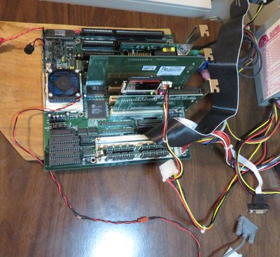

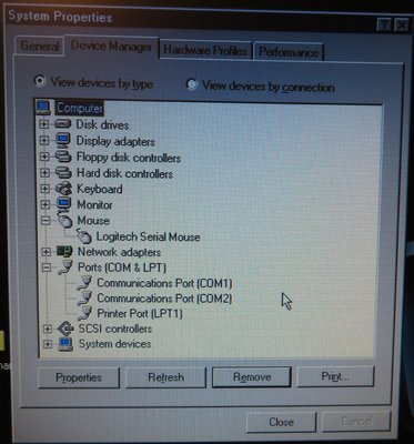

Rio444, I was able to test your ps/2-to-serial emulator card with another AMI WinBIOS motherboard, the Shuttle HOT-433 v4 with BIOS version 433AUS33. This motherboard does NOT exhibit all the same problems that my NexGen AMI WinBIOS board did.
I set in the BIOS COM1 to disabled. Serial emulator card is NOT plugged in yet. I boot Windows 95c with a serial mouse on COM2 and open the Device Manager. I still see COM1 listed. If I delete COM1 and reboot, Windows finds COM1 again (still no emulator card installed yet). So this symptom is the same as on my NexGen motherboard.
The difference is that when I install the serial emulator card and boot Windows (BIOS COM1 still disabled), it boots fine. With the NexGen board, it would hang because of the two COM1 ports. With the HOT-433 motherboard, I boot Windows with the emulator card installed, I still only see one COM1 port. No need to disable the motherboard's COM1 as it doesn't show up in the Device Manager list.
But as in the previous paragraph, if I remove the emulator card and leave COM1 disabled in the BIOS, Windows 95 Device Manager still sees the motherboard's COM1.
So it appears as if the HOT-433 motherboard's BIOS does a better job at disabling COM1, but Windows 95 still sees it, though seems to ignore it when the emulator card is installed. Interesting behaviour.
