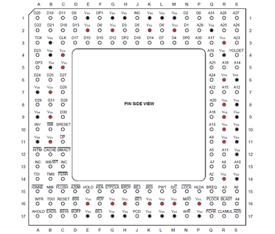

Note, that L1 was in "Write Through" mode all the time. I've just found out, that there is an internal pull-down on L1 cache selection pin of AM486 DX4-100...
I've used this pinout diagram from AMD's datasheet of DX2/4 CPUs:
102.14 KiB
160 views
pin R17 "CLKMUL" sets the multiplier, and pin B13 (which I've missed) sets either WB (high) or WT (low) L1 cache mode. Any idea how much of a performance boost would it be in WB mode @ 120MHz? Would it increase FPS at least by 2 in Doom's timedemo?

Jumpered interposer board for WB cache mode. PC posts, but stops loading into DOS just before when it should display a command prompt. PC at that point is not dead frozen, it still accepts inputs from keyboard and can be reset from "alt+ctrl+del" key combination. When turbo switch is toggled, PC simply halts, when turbo is untoggled, PC returns to normal operation. When internal cache is disabled, PC boots into OS normally. Did these tests at default FSB, and BIOS settings.
I wonder if this issue is caused by old BIOS, incompatible chipset or both. What else could be tried to make WB cache mode work on this motherboard?
Reply 25 of 25, by SSTV2
OK, looks like I'm out of luck here. For L1 to operate in WB mode, chipset needs to support these 3 new signals from "Enhanced" 486 CPUs: /HITM, INV and /CACHE. Knowing that "Enhanced" 486DX2 (P24D) was announced only in 1994, while UM82C481 chipset was introduced in 1992 or in the beginning of 1993, I can safely conclude, that it doesn't support WB cache mode at all...
All 4 signals, including WB,/WT are N.C. in UM486V's CPU socket.
Source: WB mode requirements.
